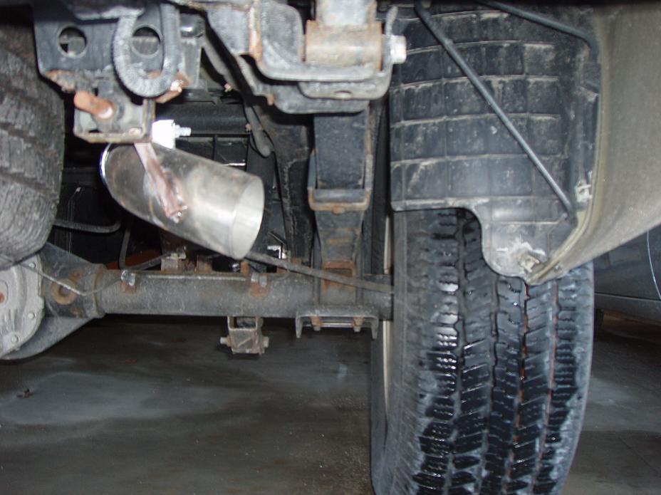

I cut 14" off my tailpipe, and that reduced my drone by at least 50%. I did it to my OEM exhaust with an 18" Magnaflow swap and with my current JBA catback. Both times it worked wonders.
