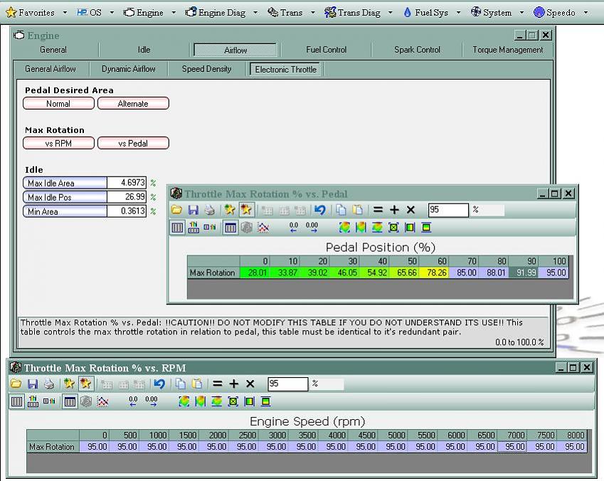

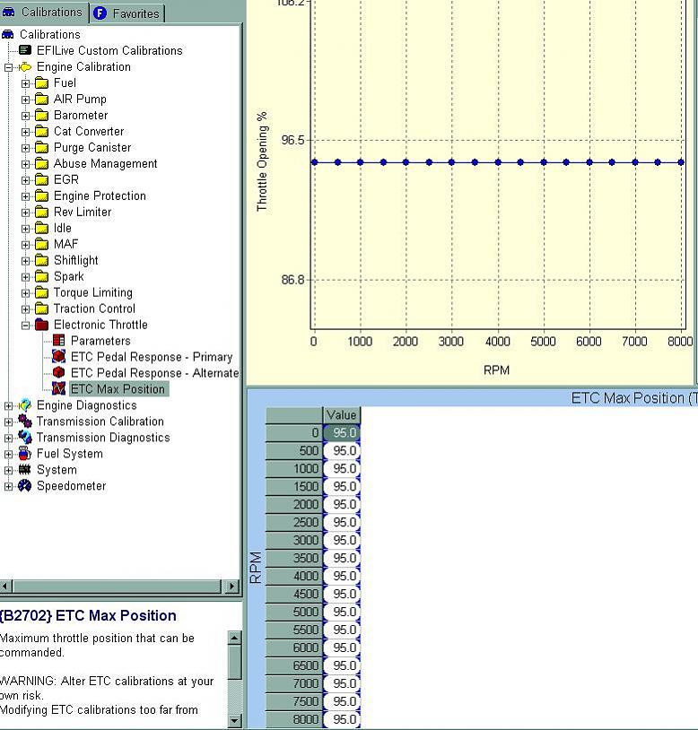

If the TB blade is trying to go too far and you cannot find the problem, you can try limiting max TP to something like 95% in the ETC Throttle tables. Of course, it will still be opening more than that.
Attached Thumbnails TBSS Throttle Body Problem-etc-tables.jpg   TBSS Throttle Body Problem-etc-tables2.jpg   TBSS Throttle Body Problem-etc-tables-hpt.jpg
