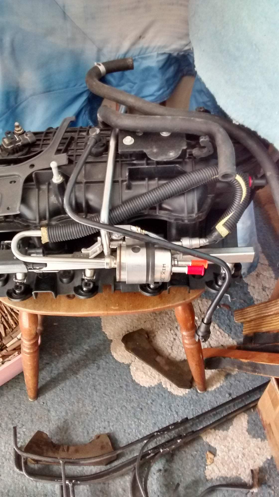

I assume that they are the same. Here is what mine looks like.
Attached Thumbnails Is this the TBSS intake i need?-img_20160324_113138194_hdr_8fe9b80a50c078e5d66dda9a9567e7f5e8aa4fe4.jpg   Is this the TBSS intake i need?-img_20160313_163908541.jpg

Remember all of the Gen IV 4.8's and 5.3's got the same intake as the TBSS and if you can find one off a flex fuel truck it should come with 36# injectors instead of the stock TBSS injectors that are 29#. If you still have the stock '03 5.3 injectors on your truck I think they're around 25# so either should be an upgrade for you. FWIW I found my TBSS intake for $140 (w/TB, injectors, fuel rails, and sensors) and then picked up a new set of the 36# injectors for $55 off ebay.

The only thing that needs to be accounted for, is that the flex fuel equipped trucks had a different fuel rail to accommodate the taller flex fuel injectors. If you plan to use another (shorter) injector with that rail, you may need injector spacers to make up the difference in height. The non flex fuel trucks came with rails that were the correct height to retain your shorter oem 99-07 injectors.
