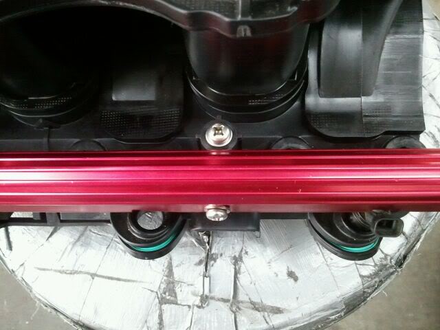

I just dropped some pro flo xt rails onto an NNBS intake a couple hours ago. Intake requires a little modification, but works fine

Yeah, had to grind down the mounting posts. Quick work with a flap disc on a grinder, but be sure to use an old disc...the plastic clogs them up. They are the long injectors.

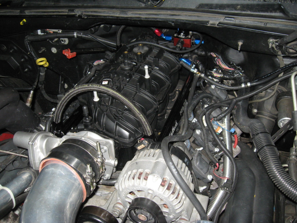

A few mods, they go on just fine.
Old Jul 11, 2012 | 07:21 AM
smokeshow's Avatar
Mod with training wheels
Joined: Feb 2009
Posts: 7,741
Likes: 207
From: Detroit
Its a little more of a pain in the *** with longer injectors, as they lean towards the posts more and you have to grind the posts, otherwise the injectors don't seat right. Yours looks real clean though.
Originally Posted by Spoolin
Pics or it Didn't happen!!!
Better pics coming when I get everything in place and tightened up Also, there seems to be something wrong with your turbo too, it keeps choking...you need a bigger one

Not too bad. I ordered some spacers that will make the fast injectors about 60mm tall.
