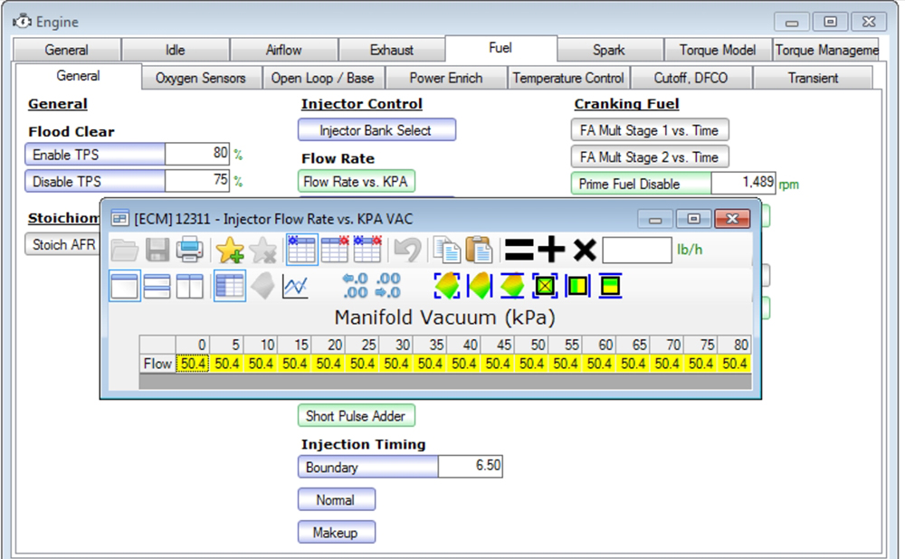

You do know those 50lb/hr injectors are for the Gen4 engines. When used in the Gen3 engine the injector data has to be converted to Gen3. If that hasn't been done let me know and I can post the converted data.
Also the injector flow rate for return type systems is static meaning the flow numbers are all the same across the table. Return systems rely on the vacuum referenced regulator to mechanical adjust the flow.
When you swap to the C5 Corvette regulator it is a non vacuum referenced regulator just like a non return system and uses progressive injector flow rates in the tune.
This is what it looks like...
Return systems with a vacuum regulator (static flow rate)
