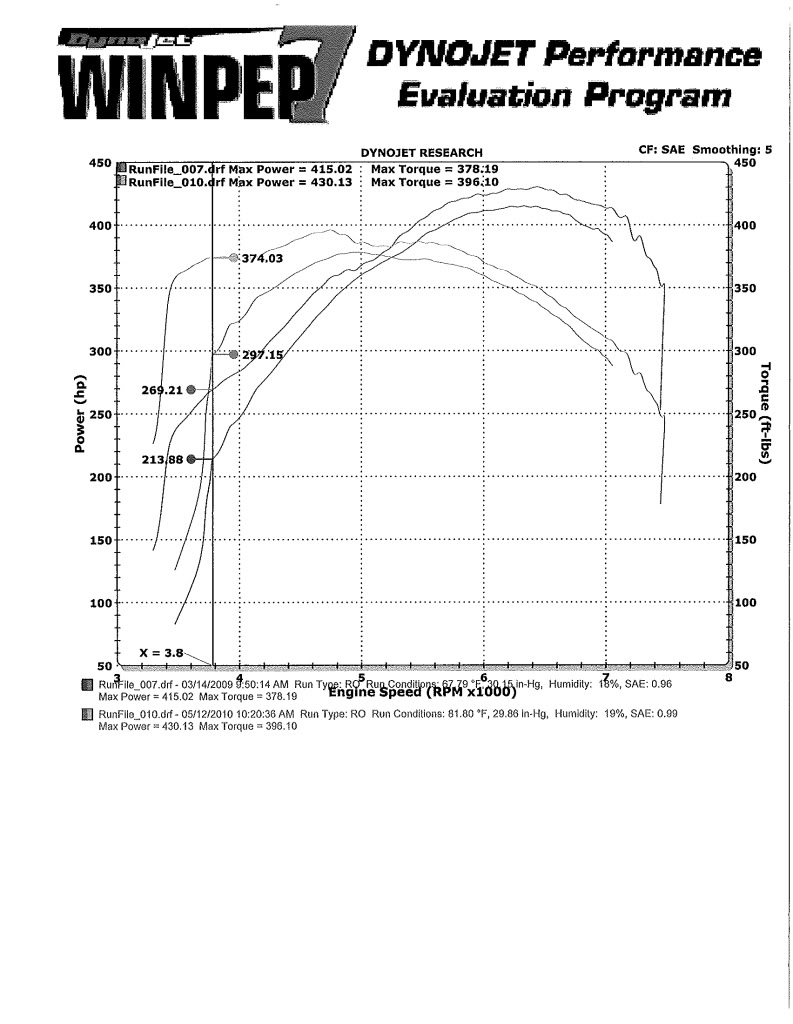

there were pictures of a set of TSP headers sitting next to a set of kooks headers and the bends looked IDENTICAL. yes kooks are stainless but if you live in a area with low rust hazard you cannot beat the price of the TSP 1 7/8 headers. i doubt the possible gains of the stepped header will outweigh the cost difference. stepped kooks are NOT cheap and do not fit perfectly every time. FWIW my LS2 s10 will have 1 7/8 longtubes.
as for those who think that 1 7/8 will lose torque down low dont believe it. my setup alot going from 1 3/4 pacesetters with ory and 3" dumped to the stepped kooks 1 7/8 to 2" with true dual 3" exhaust. I also added a ported fast intake at the same time which everyone claimed was a down low torque killer. here is my proof to not believe all of the internet theories and hype. here is they dyno sheets of my before/after on my my exhaust and intake change. the intake change was going from a stock LS6 manifold (pos) to a ported fast 90mm setup. i think it was a decent gain. damn i miss this old motor RIP lol.

yeah my before and after dyno was for both the ported fast 90mm and the headers.
in hind sight, after spending around 1,500 on the intake swap, 1,100 on kooks, and 1,500 or so on the pacesetter heads, and no telling how much on the nitrous kit i never got to use...
i should have taken that money and gotten a turbo kit!
