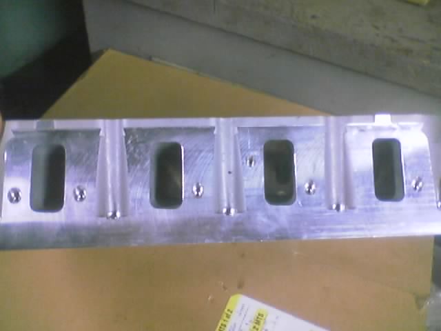

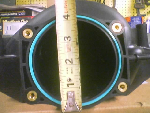

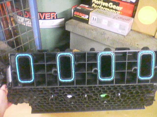

well its almost winter now and almost time to start working on the new setup. heres a few of the new goodies
first up is a L76 intake from the austrialian elcamino. it has a 90mm TB opening as you can see by comparing it to the tape measure its quite large

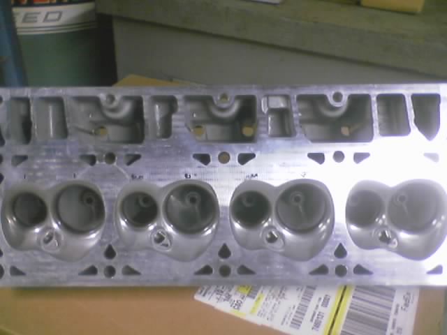

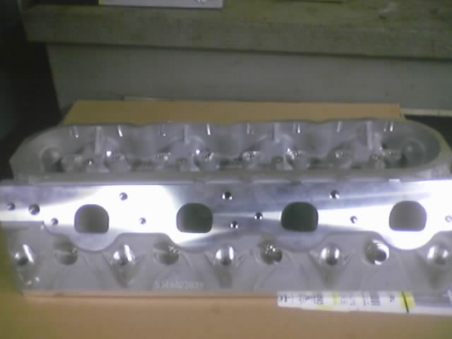

second up is a set of L92 heads. they flow the best of any stock production truck head avaible. something like 335 on the intake side. 2.16 and 1.6 valves i do believe they are stock on the new 6.2 esclades and will work well with the new 408

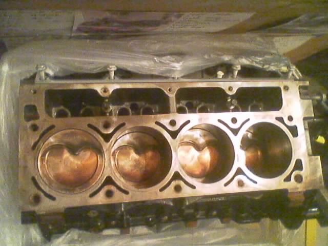

now heres the fully forged Lunati 408
cam specs are 244/248 .612/.615 112+2 lsa
and some LS7 lifters once again

i also plan on spraying the 408. im hoping ot squeeze out around 10.8CR with this setup. sucks that the L92 heads are 71cc heads and not much meat to play with to shave off
