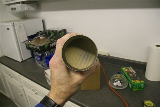

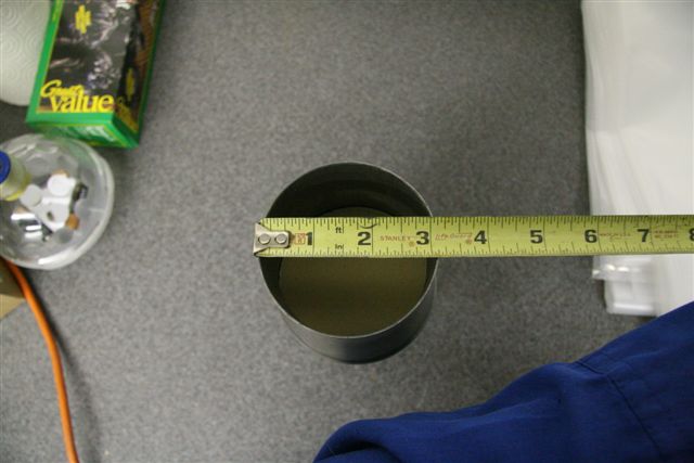

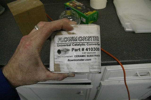

Default Pics of Flowmonster Cats
These are the $42.00 Flowmonster cats. They are stainless and seem to be decent quality. I believe the can be cut down to be in the 8" length range, witch I will be doing.

those are ceramic...the others are metallic...much more durable...way better flow...magnaflow makes some like those as well I believe for about the same price on e-bay
