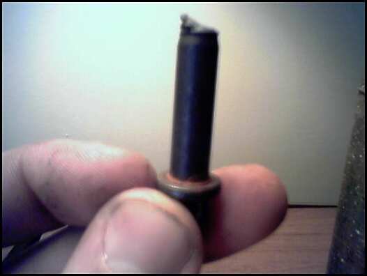

The new ****** bolt just sheared off at the top of the threads and the bottom half is still in the head. After I get the old one out when Im torqueing the new one pop there it goes I hate ******* cheap *** gm and thier cheap *** parts. Im working on this in the driveway its my only ride and now Ive got to try and find a machinist to make a house call.

Why don't you just drill the center of the bolt and use and easy out---worth a try?

What are your torquing to?
