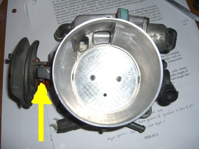

Open the throttle blade slightly by using the throttle screw. Maybe a 1/4 turn or so.
I used my much less than awesome MSPaint skills to show you what/where it is.
You can do it while it's off the truck. The "trick" thing to do, is to remove that Torx screw and install it from the other side. That way it is 10X easier to access when it's on the truck. I "think" it's a T-15 torx bit, but not 100% positive.
I'll all but guarantee this "cures" your problem...

I did that to mine as well because it was sticking too. Haven't had any problems since and its been a couple of years.

Guys, got it fixed. It was exactly what rel3rd said. The idle screw is indeed a T-15. I inverted the screw and raised it a bit. It took me several adjustments but now the pedal is smooth as can be. The idle went up to about 600 from 500. No big deal. I love this forum.
