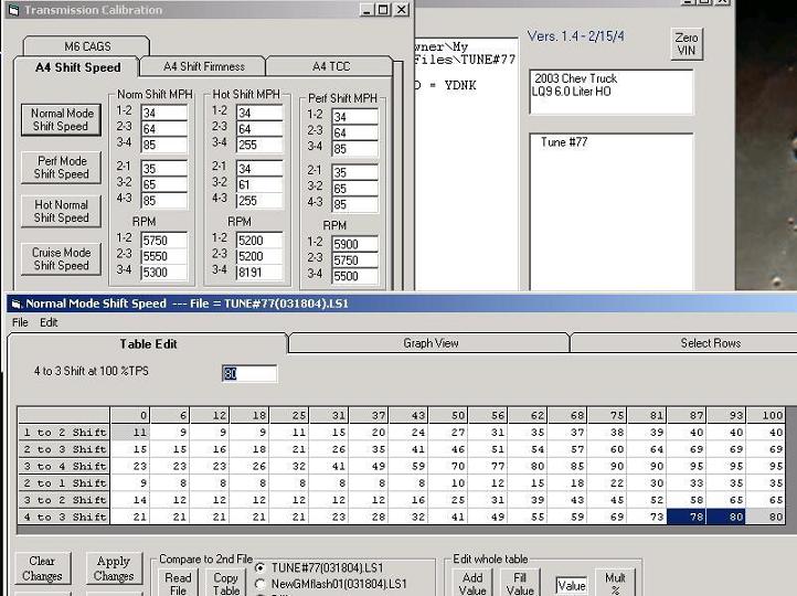

If you look at this screenshot of my trans cal, you can see that I set the 4-3 downshift to 80 in the table and 85 in the columns. It won't downshift above 80, so the table seems to control that one. (or maybe its more like, "check the table first, then check the columns" in the PCM)
