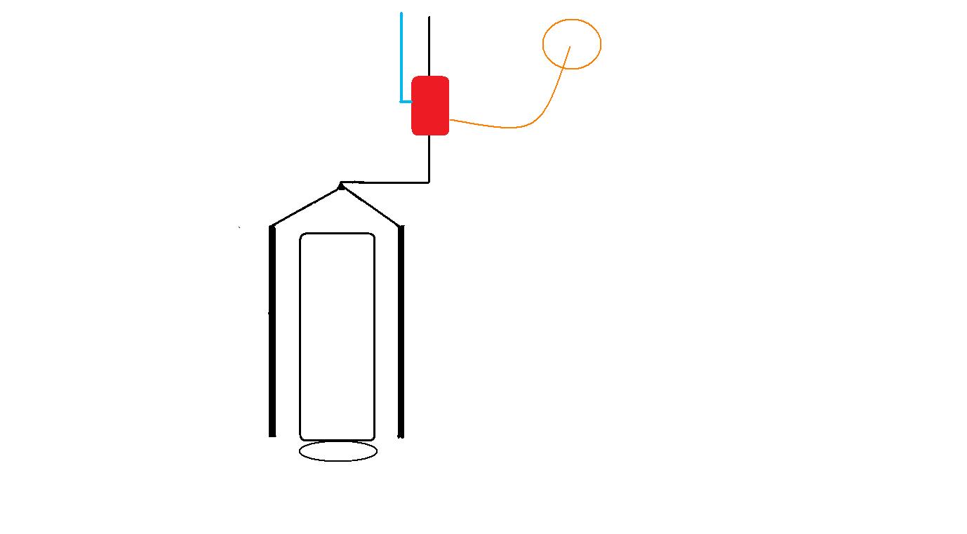

Thank you, I was under the impression you were talking about using the FPR as the T itself..Ok that makes sense now.. Would this function correctly, as far as bleeding off the excess fuel from being dead headed in the rails, rather then coming back into the reg from a pressurized source.. This would prob be the way I would go about it, any where in front of the reg i could tie into the line to add a FP gauge, then it would be no lines other then feeds to the back of the rails..

Well none the less, if the FPR works like a relief valve on a hydraulic system, then it should not be a issue as far as bleeding off fuel that way, a FP gauge should be able to be added anywhere that there is pressurization in the system.. That is a super clean way, i might have to go for it, it would save alot of time as far as making bends in hard line. Hell this should get a sticky spot, for anybody that might get a little confused as to a configuration.. Thanks to you guys for making this a bit more clear to me..
