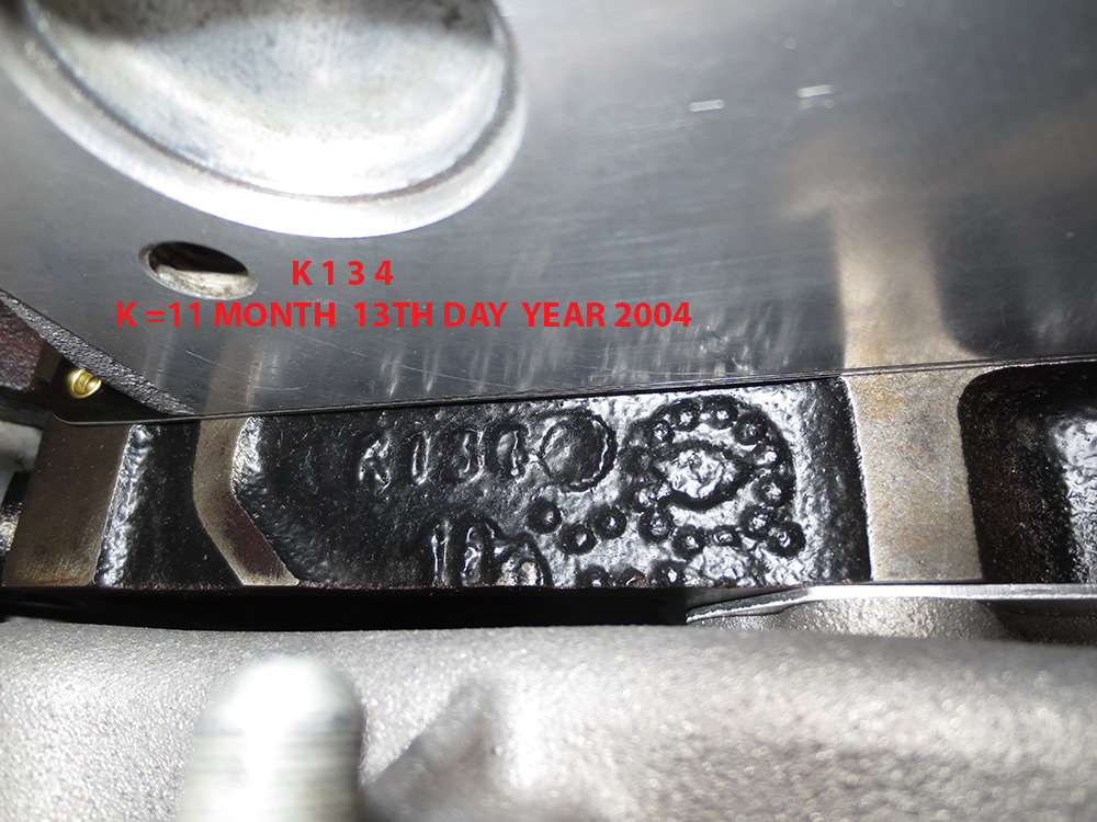

Originally Posted by 1970hemicuda
I was definitely thinking of staying with a lq4 for the lower compression. Did everything after 04 have gen4 rods or was it a transition period and it wasnt guaranteed?
That would be a question probably better asked over at the "tech" forum. I've seen a thread over there and IIRC 03 was a crap shoot with the gen4 rods. The casting date code is just below the bank 2 head on the block.
I found this engine from a 2005 Escalade (LQ9) with the date code K134 (November 13th 2004)
