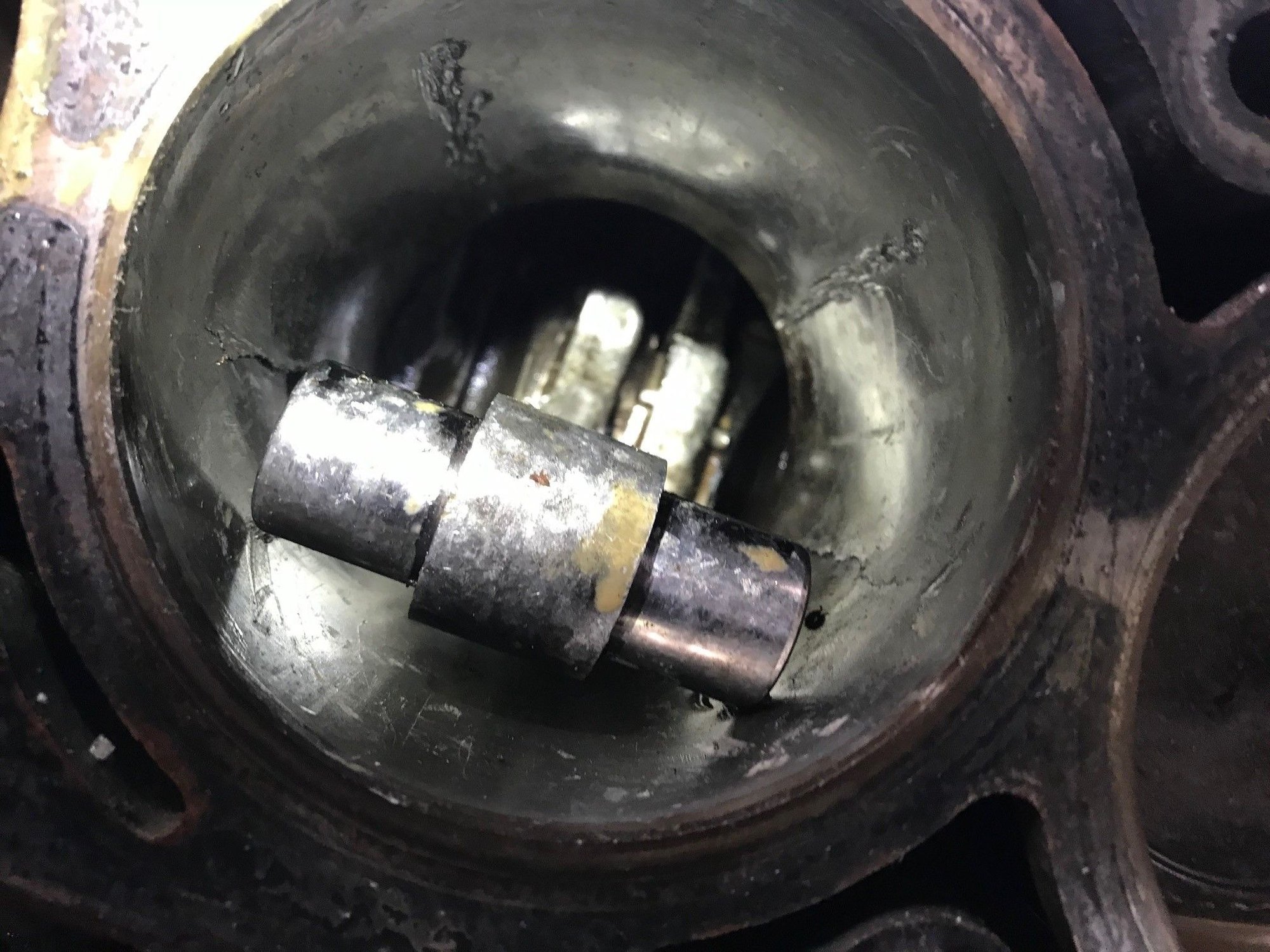

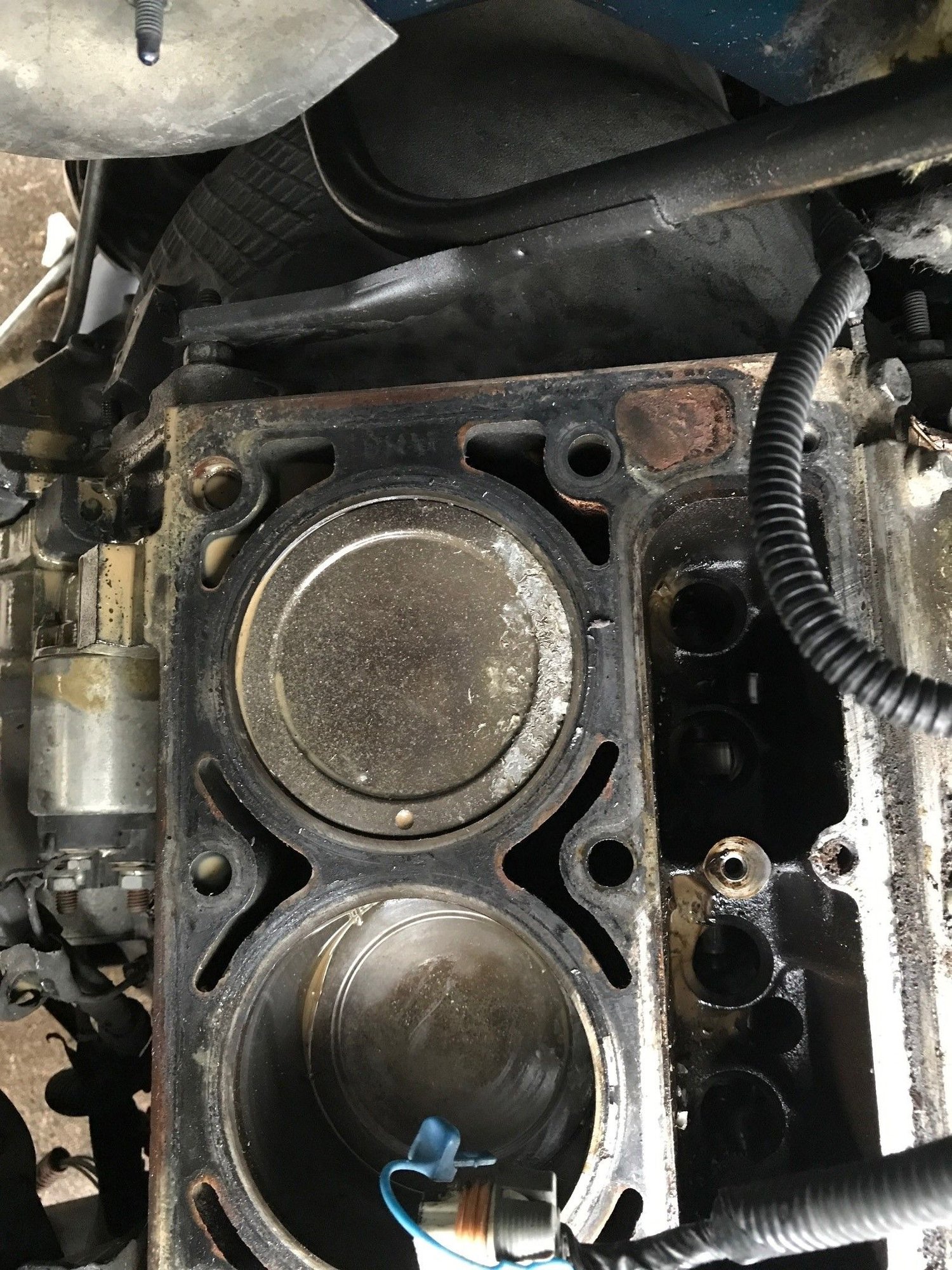

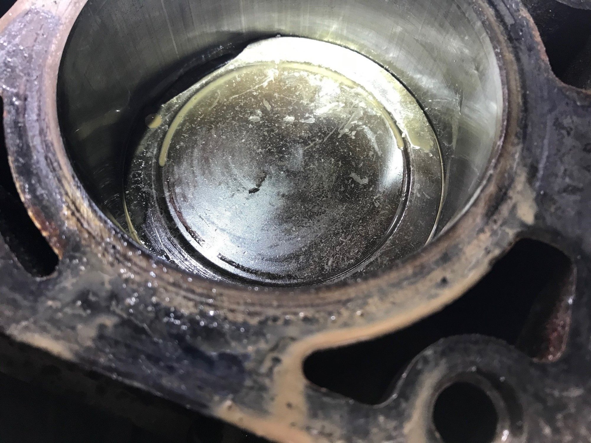

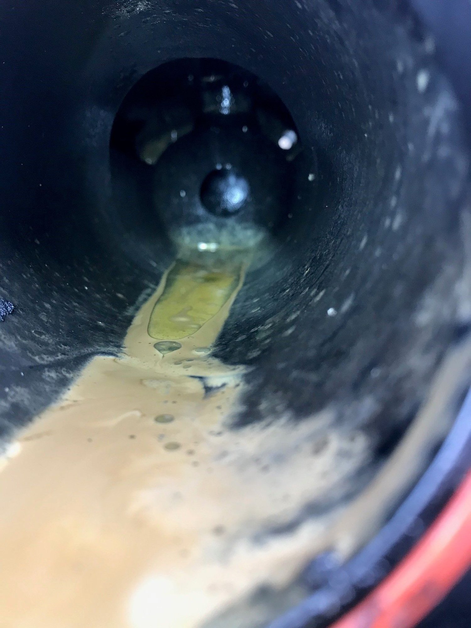

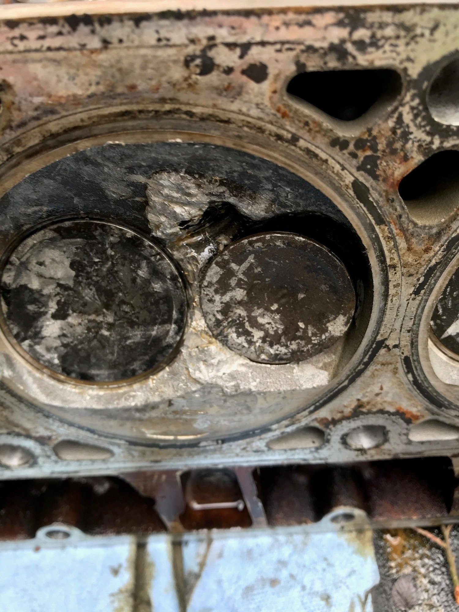

Got the engine apart this weekend, damage is worse than I expected. Not really sure how the entire #5 piston can be gone, still trying to sort out in my head the sequence of event that went on inside this engine.

That’s some impressive carnage right there. I’m gonna say your #5 piston is what’s in that red tray you posted.
