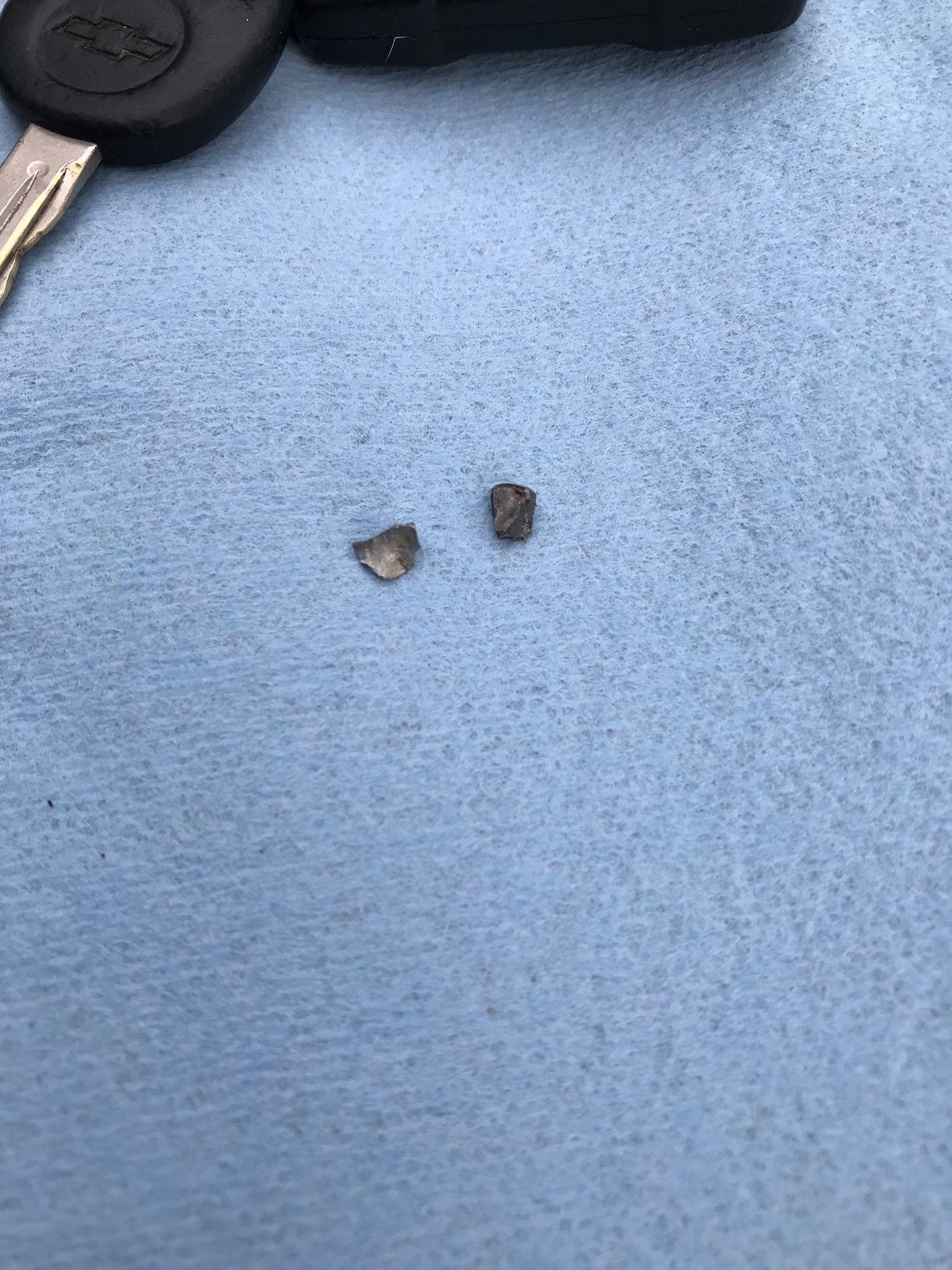

Drained the oil last night and found more metal on the drain plug magnet than I like and a couple of small chunks of aluminum.

I expect head damage, piston damage and maybe block damage at this point
My fear is you are right.

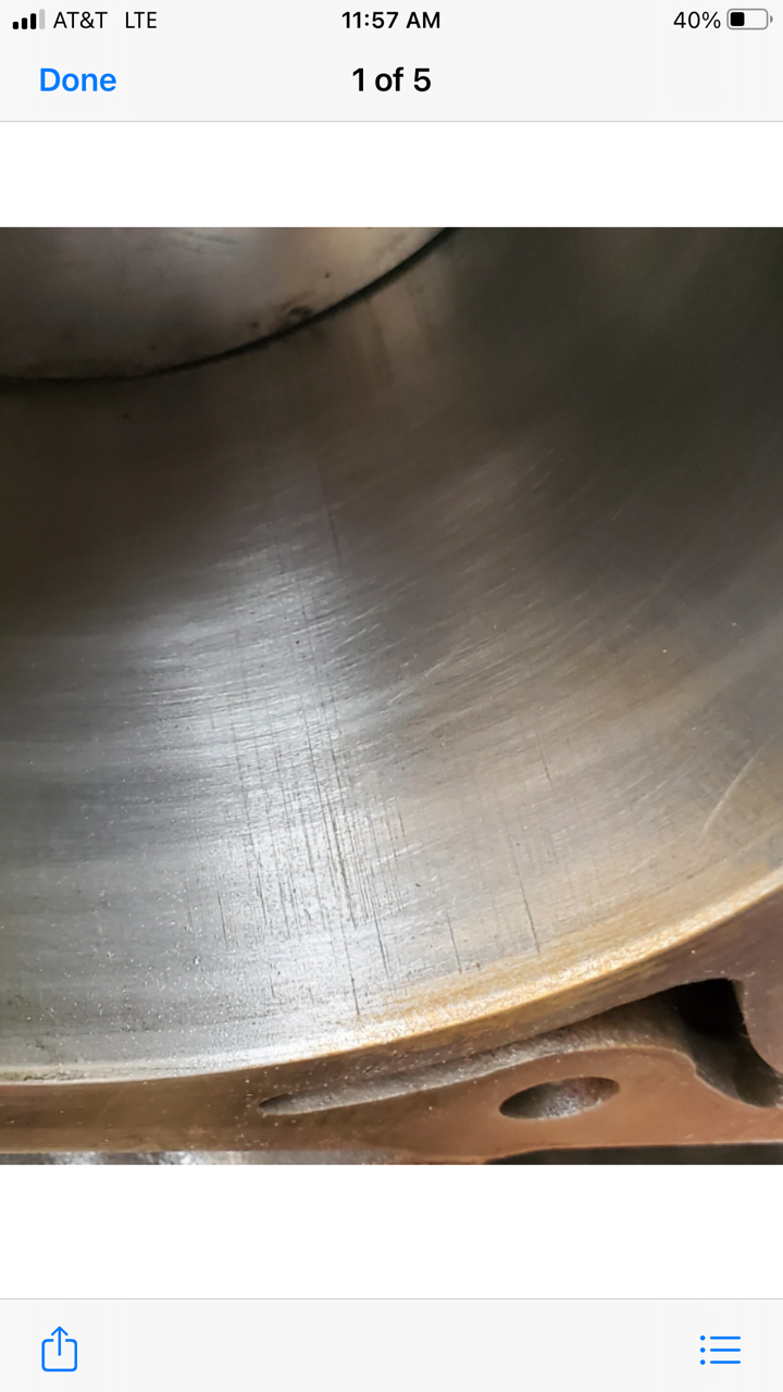

Still have not had time to tear into engine yet but found a rebuilt 6.0 shortblock for 1800.00 in the Houston area. Got the guy to send me some pictures of the cylinders but I`m kinda concerned about scratches in the bores especially for a fresh rebuilt block. Check out this photo, should I be leary of this one?
Old Mar 4, 2022 | 01:20 PM
arthursc2's Avatar
Joined: Jan 2014
Posts: 4,341
Likes: 1,517
Meh.....
I mean, for $1800 and "rebuilt" that's not great. In the grand scheme we have seen worse make a billion HP and last 100+ passes
if that had been my motor I would have bored it, maybe stroked it! But then 5yrs later I would put it in an entirely different chassis and it would run on 4cyls..... wait, I've seen this before
is the motor close enough for you to go see? Those might just be rubbed spots and not actually scratched. For the money it's not perfect, but I doubt you'll have an issue if you decide to run. Knowing it's there there is the worst part of the ordeal lol

That "rebuild" looks like a Krylon "rebuild": dingleberry hone on a block that had a serious steel failure in it. Cam lobe/lifter going down, stuff like that. Garbage.
It's ruined.
No way I would consider a block "new" and/or "runnable" with that many vertical scratches in it that are that serious. Esp with boost. Keep looking.
Personally I'd just look for the motor out of a grandpa truck that he drove off the side of the road, and just run it as-is, if I could find such a thing. No sense in "rebuilding" anything if you don't have to. The $$$ difference between a CHERRY 5.3 JY short block and a "core only" one is AHELLUVALOT LESS THAN the cost of a "rebuild".
