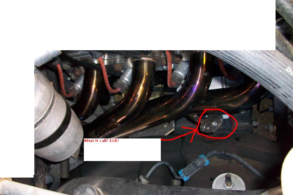

The obx header on right side (passenger side) the tube I dont know what it call. Its EGR? How can I find to mount it. Because I plan to order obx header on ebay.

Yeah that's the egr tube, the headers will come with a plug inserted into that hole to block it off. You can't order the headers without the tube.

I went for a drive and that little screw that goes in the EGR to block the hole had blown right out! Luckily it was just sitting in my engine bay.
can you please post this picture unedited, I want to see how close those primaries are to the frame. Mine have 1/8" clearance when cold but when I run the truck they bang up.
