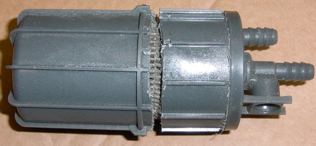

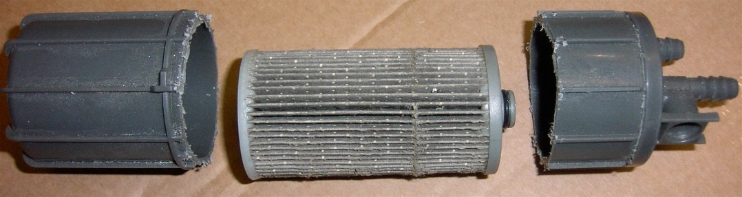

Here's the one I pulled out of my fuel module:
Attached Thumbnails no fuel filter fuel systems in new trucks-picture-002.jpg   no fuel filter fuel systems in new trucks-picture-004.jpg
That filter is dirty! How many miles are on it?
Jim
Maybe 15,000. How long is "lifetime"?

Originally Posted by 4.8T
sweet now i know what it looks like. my book said it was intank but "unserviceable". it also says to blow the lines clear when you change it.
Seems that sometimes the manaul is referring to the old style external filter and other times to the in-tank filter. This one could be replaced if one was available but you would still have to drop the tank, replace the flex tubes and clamps and switch the regulator over to the new filter. There is some variation in filter/regulator designs between the different fuel modules.
