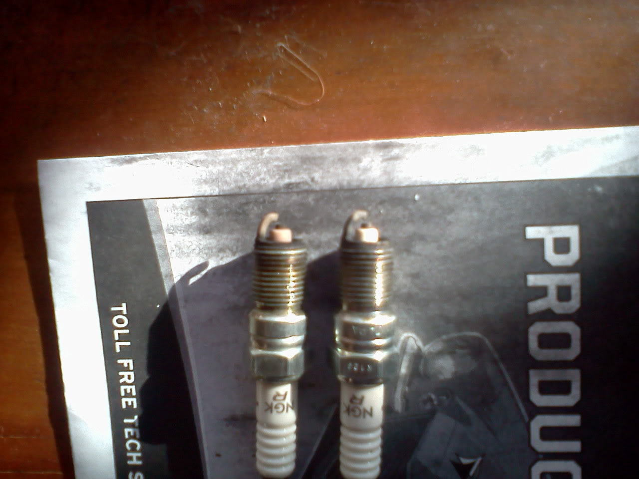

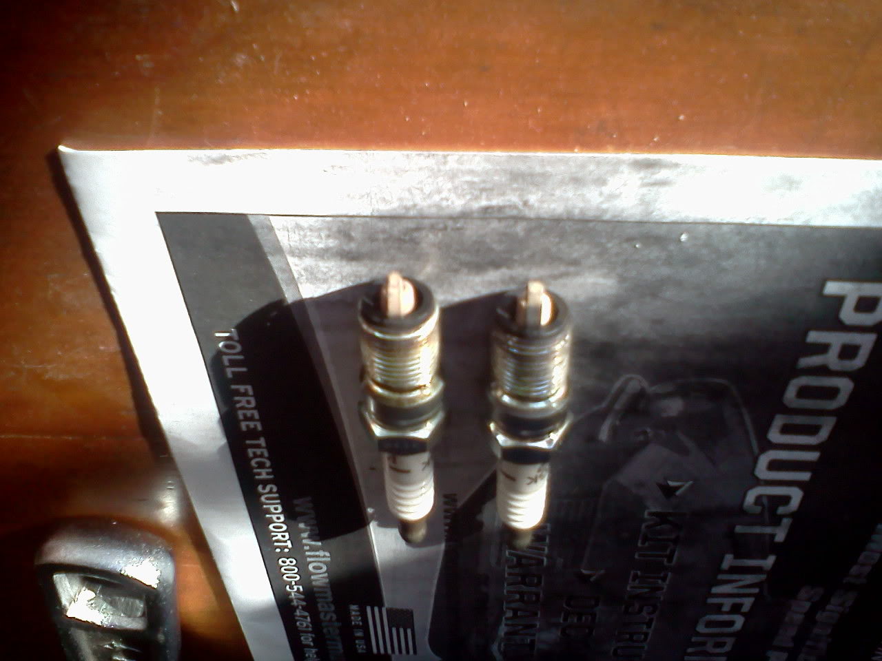

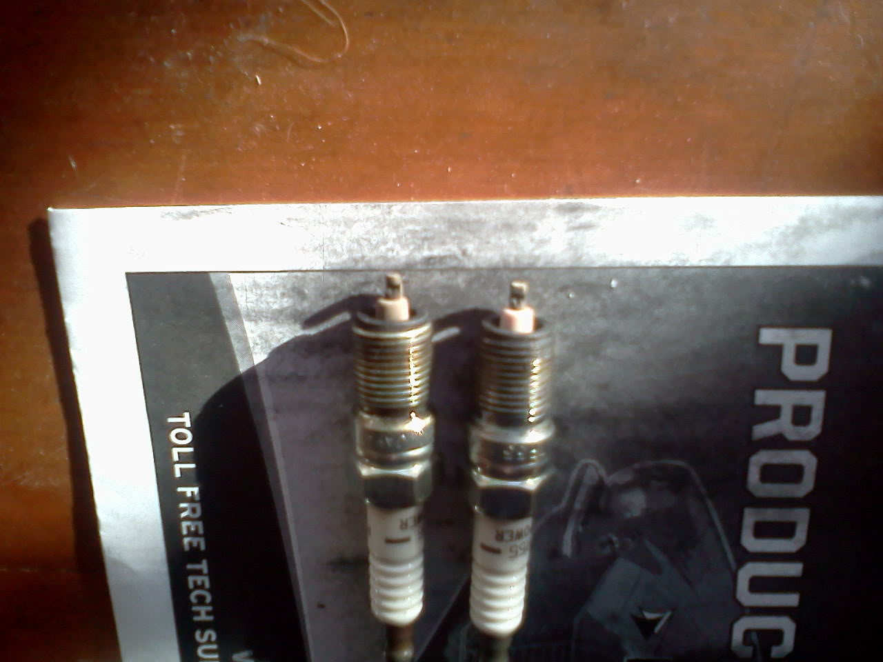

No use in starting a new thread about this.
In my engine, based on how these plugs look. Would you use the TR55 or the TR6:
The ground straps are modified, not eroded away.

TR6 from cyl #1 on the left, TR55 from cylinder #2 on the right. Both plugs have the same mileage and use on them.
The TR55 appears to have a cleaner porcelain, yet on the ground strap by the base has more carbon than the TR6. Neither of the plugs are showing any detonation, which is really good
What would you run?
Old Jun 21, 2011 | 01:11 AM
  #37
AKlowriderZ71's Avatar
11 Second Hall Moniter
Joined: May 2008
Posts: 11,651
Likes: 10
From: Wyoming
To really read a plug correctly, you've got to cut it open.
