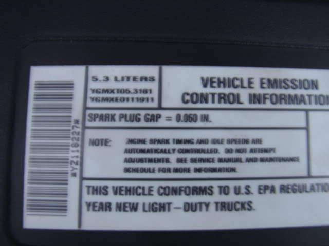

Originally Posted by 00ChevyScott
99+ V8 (exc 8.1L) is .040 for all the plugs listed.

That's for the old platinum plugs Corey. Did you read the TSB for it that was posted?

Originally Posted by BlackGMC
i bought some ngk plugs and they came pre gapped .040 should i regap to ..060?

No Lee, leave them at .040
