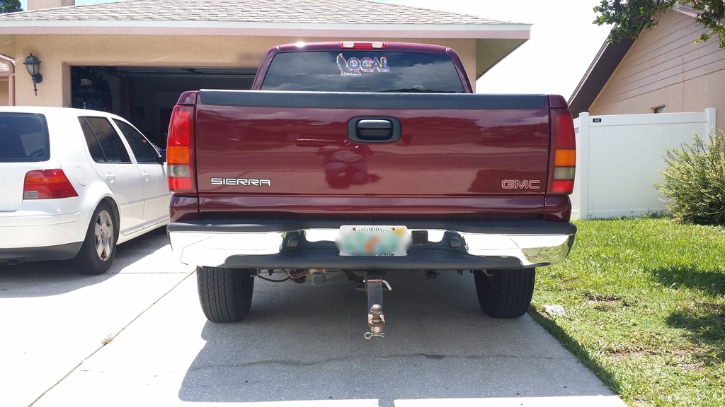

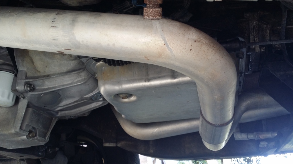

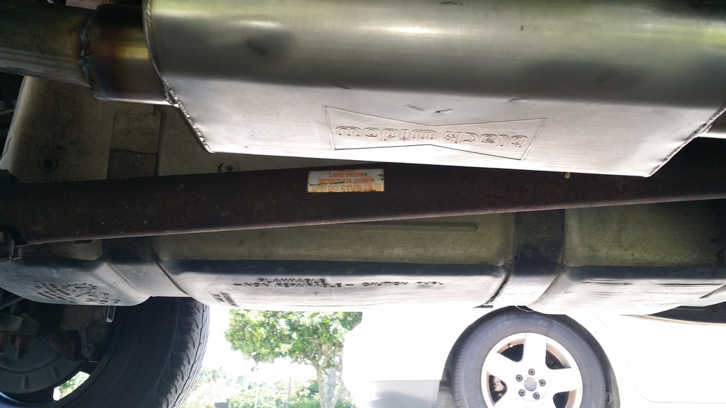

this is the rest of the exhaust.
after the cat it runs stock up to the blackwidow muffler.
and up and over the axle with 2.5 pipe dumped behind the hitch.
<a href="http://s128.photobucket.com/user/truefire98/media/20150720_142712_zpsegwjx0mr.jpg.html" target="_blank"><img src="http://i128.photobucket.com/albums/p188/truefire98/th_20150720_142712_zpsegwjx0mr.jpg" border="0" alt=" photo 20150720_142712_zpsegwjx0mr.jpg" style=""></a>
<a href="http://s128.photobucket.com/user/truefire98/media/20150720_142731_zpsw9fh22g1.jpg.html" target="_blank"><img src="http://i128.photobucket.com/albums/p188/truefire98/th_20150720_142731_zpsw9fh22g1.jpg" border="0" alt=" photo 20150720_142731_zpsw9fh22g1.jpg" style=""></a>
and can't be seen from behind the truck.

Wow that is some craptastic exhaust!
I hope you did that with spare pipe and didnt pay for that.
All those pipe size and angle changes at the weld points probably makes for a very raspy sound.
My first attempt looked very similar and it sounded like ****. Ended up doing it all over again a week later with proper sized pipe and fittings.

I have to agree with ezdaar.... After having time to actually look closely at those pics of your exhaust.... Ummmm who made that ory??? So i know not to buy one... I hope that o2 is a rear one that has been tuned out anyway, that has absolutely no exhaust getting to it.... I dont think theres really too many pipe size changes persay but it could have been flared better.... The intermediate pipe going into the muffler could have been expanded to help with the transition instead of that gumball weld that looks like is on it... On a side note i m actually contemplating doing something stupid, more for functionality that form.... Taking my old ypipe from my 5.3 cutting the y off after the cats, running my new cats into it.... Going to the local scrap yard and getting the same piece (pipe after cats where they straighten out and go into the flange) along with both sides of the flange and essentially turning the end of the ypipe and beginning of intermediate pipes into a bolted together x pipe of sorts.. I need to draw a diagram or photoshop what i mean, i think i tend to lose people trying to explain it.... Not sure if it would be worth the effort but it would be a cheap easy, fun way to fix a clearance issue im kinda having with my exhaust at moment over the bastardized trans crossmember my 99 has....

the ory pipe is a jegs and had the exhaust guy weld a sleeve in since he fixed it because it leaked. and as for the muffler he welded a piece of pipe inside the inlet then welded it to the stock piping. and the pipe only drops down a 1/4 inch from stock. stock is 2.75 and the new pipe after the muffler is 2.5 its a little raspy when cold but that's it.
