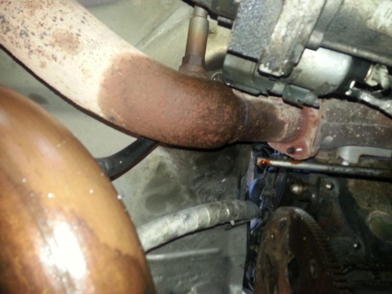

Originally Posted by Wolftrk99
Any ideas on the best way to merge a 3" cat to a 2.5" pipe, without part of the connection being essentially a brick wall???
Use a short section of 2.75" pipe to taper it. My factory exhaust stepped up from 2.5 to 2.75 to 3" right out of the manifolds all the way to the cats and into the muffler. This is a 99 I am parting out but my 97 was the same setup.
