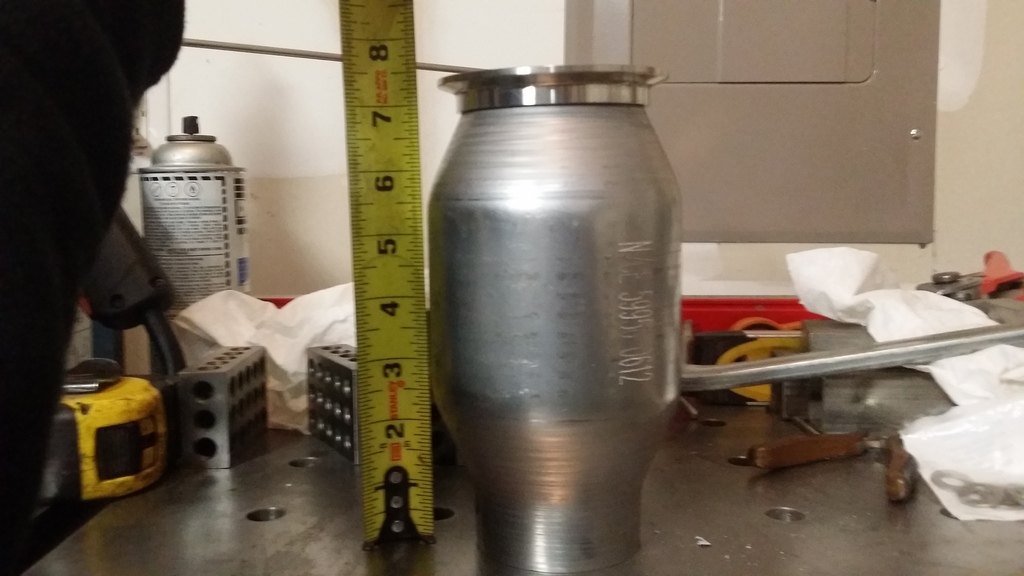

Likes: 29
From: Earth

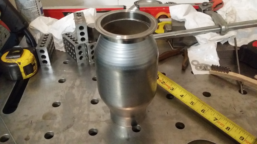

7-3/8" tall as is. I can probably take a little more material off to shorten it down some. And if you want to do a 3" out exhaust, that'll also shorten it to basically the core, hah. I'd guess it would be around 5.5" long.

I think you'd have to order 2.25" cats if you were planning on cutting them down.
The ones I have are 2.5" and I cut them down to have a 3" inlet.
