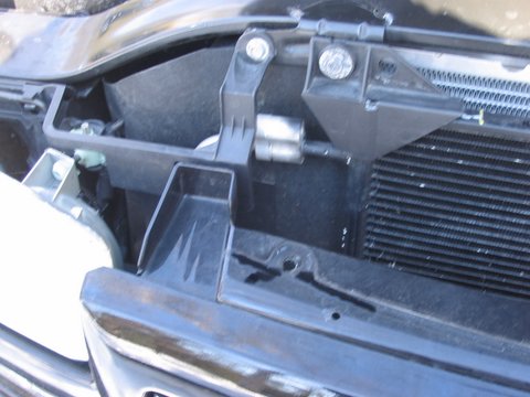

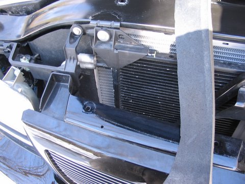

One thing I neglected to post is make sure you trim the rubber flaps on each side of the radiator behind the grille. They'll cover the new expanded 6.0l radaitor surface.
Heres some pics
before and after.
Attached Thumbnails My official GM 2005 E Fan post(large pics)-before.jpg   My official GM 2005 E Fan post(large pics)-after.jpg

Thanks for the reminder on that. I'll be doing mine soon. I did end up getting Allen's last 145A alternator.
