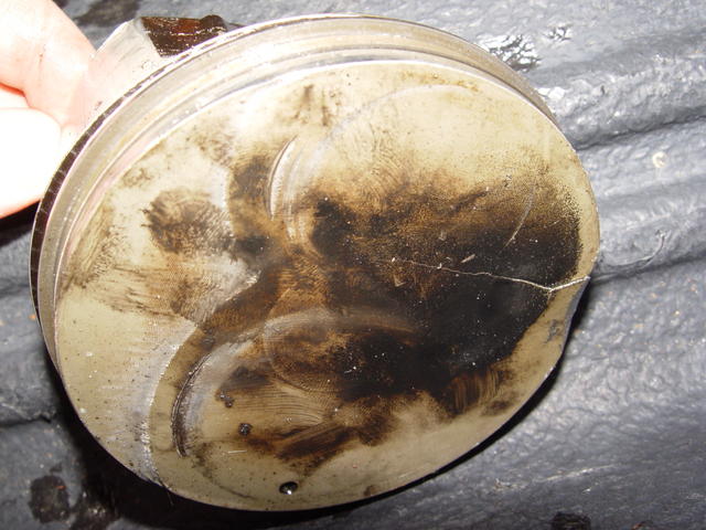

lets see.... we had a cam similar to the tsp tv2 in it with ls7 lifters 918s. wasnt even shifting high maybe 6400rpms. was out testing the day before the show. on my 5th launch i lost oil pressure motor shut off after the 2nd gear shift and dump oil everywhere.
pulled it apart.... oil pan full of internals....cylinder wall chunks, rod bolts, rods, rod pins, piston parts, rod bolt stamped the oil pickup tube perfectly. so much debris. i never seen a block just fall apart like that. the messed up the crank, bent our new cam, bent push rods, bent a few valves. front two cylinders just gone. pulled heads off and the pistons where in there wedged crooked
this could of happend to any motor but im not a fan of 98s personally

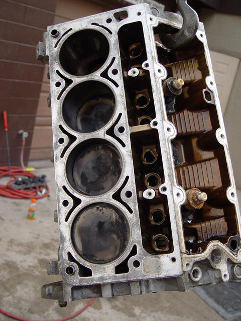

ok heres the carnaige
looks closely you can see the walls gone
Attached Thumbnails Motor Build-up...some questions-dsc00346.jpg   Motor Build-up...some questions-dsc00347.jpg   Motor Build-up...some questions-dsc00348.jpg   Motor Build-up...some questions-dsc00349.jpg   Motor Build-up...some questions-dsc00355.jpg

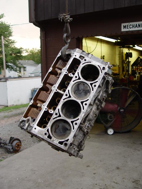

some more
Attached Thumbnails Motor Build-up...some questions-dsc00356.jpg   Motor Build-up...some questions-dsc00357.jpg   Motor Build-up...some questions-dsc00358.jpg

those are definately some serious carnage pics but little can be seen about the block in those pics. Not saying you are wrong cause clearly the piston/pistons were cocked, I have read the 97-98's were weaker and this is the closest think I have seen of pics but still not convincable. But I have nothing to put up that they are not weak so please take my words as just being a skeptic not fact.
yea kinda hard but you can see some. i didnt take the pics i was busy ripping into a 210,xxx mile 6.0 to use for the backup motor. thats what won the show. a 6.0 out of a flooded towtruck. swapped springs, couple cans of carb cleaner to help get sludge out of motor. a few gallons of water to flush the collant system and 50 weight oil to make our passes and take home the oppeants car
