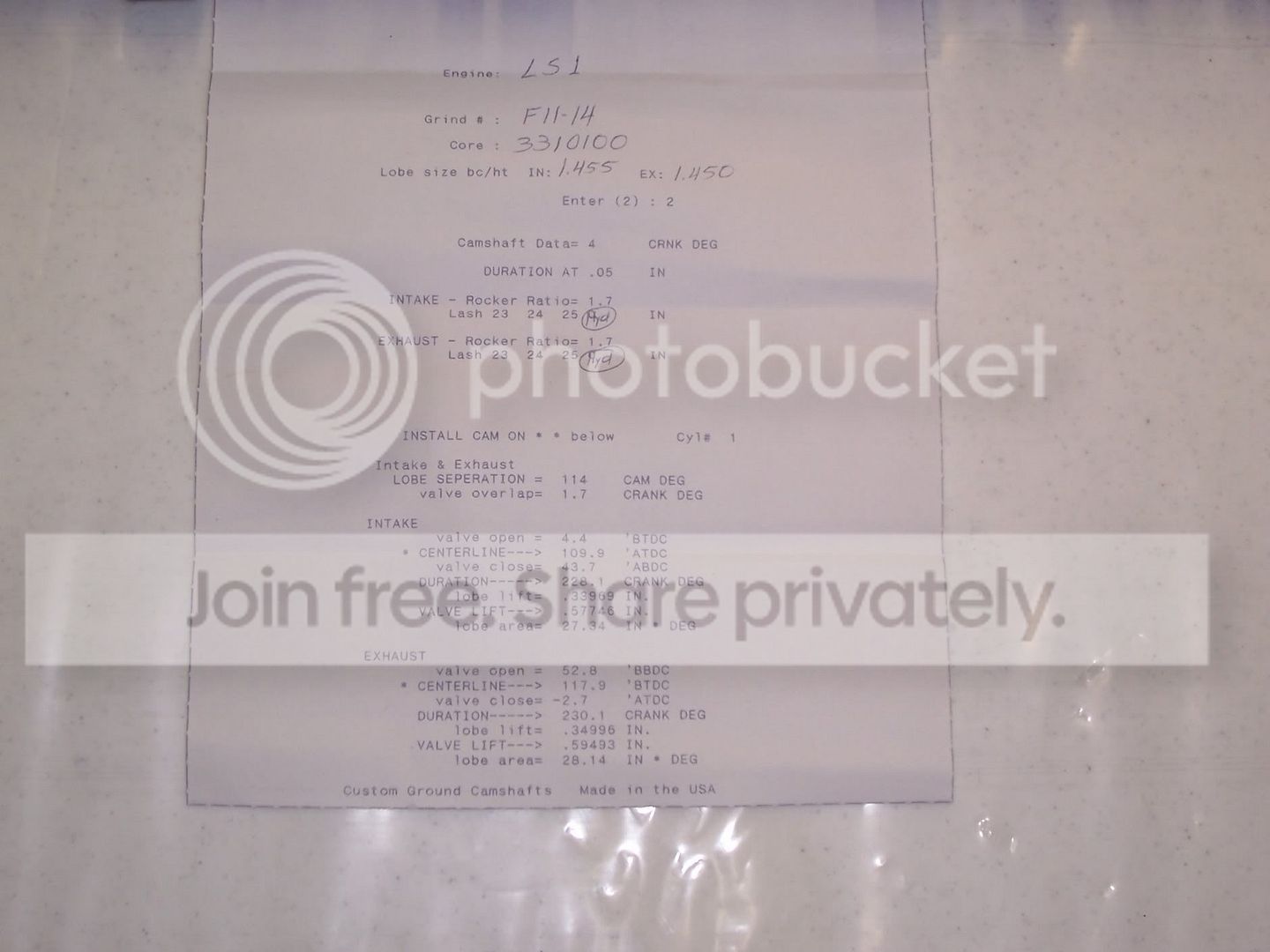

Flow numbers aren't everything... Heck, look at all of the SBF, EFI intake manifolds that are available. Some are crap, others flow. I was in an unsure position so I just sold it. A FAST intake however, should definetly help you with those 6500+ shift points.
What kind of exhaust are you running on the truck?
Is the FM11 on a 114*LSA+4*?

you're more keen on this than I
yes its on a 114
Im running a TD setup 2.5" over the trans crossmember into a x pipe and 14" magnaflows
