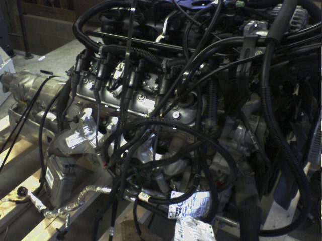

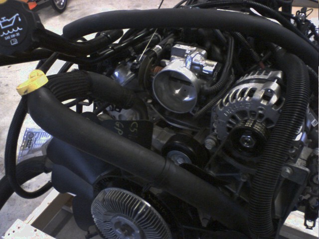

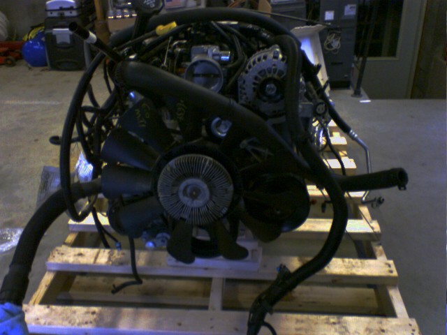

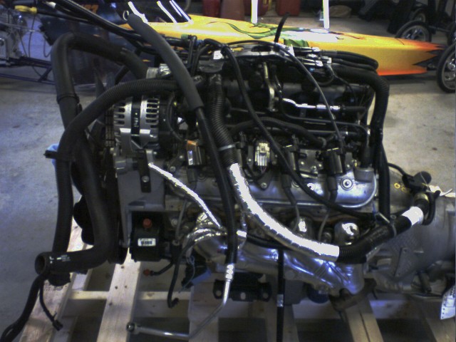

well here are the pics! and yes the third pic has my sister's JR

I REALLY hope you've got JRT's book on doing this swap.....it's not all that hard but the wiring end of things is an absolute BITCH !! Contact John at Speartech and he can hook you up with a harness that will solve ALOT of the wiring issues you'll run into. You'll also need to swap out the intake and injectors for f-body ones unless you plan on running a 4" cowl hood. (I've helped on two of these now)
The '98 ECSB S-10/2002 5.7 LS1 swap I recently helped with has managed a best of 13.2 in the 1/4 mile....and that's with a completely stock LS1 and 18" wheels
