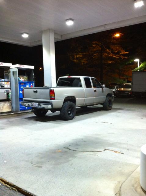

Hey all, new to modifying trucks but not modifying cars. Looking for some advice before I proceed any further on mods.
I have a 07 Classic Sierra, its my daily but I also use it tow my race cars around. Overall goal for the truck is a fun, powerful street truck that I can tow my cars with.
Ideally I would like to run mid-low 13s.
I have the L33 5.3, 4L60E and a 3.42 rear gears. Current mods are a airaid MIT intake and 3" exhaust. Long tubes are on the way.
With that being said, I need some advice picking a cam and converter. I was thinking something along the lines of a 224/232 cam with around .550 - .590 lift with a 2800 stall converter.
Any and all advice is appreciated.
-Joe

That seem like a really big cam for just a daily driver in my eyes, might not be super friendly.
Do a 3000 stall and some 3.73's to help out alot too.

With the converter I would go tripple disc 3000. And a must is a trans cooler. I got a true cool 40k on ebey shipped for 135. That is a big cam. It will definitely sound nasty. I've been lookin. A lot of people r runnin the 224 224. Or even a 228 228 cam. I'm gonna go big when I do my cam. I'm thinkin the same cam u said. I'm not gonna pull a trailer tho. Gears will be another good mod. It's a night and day difference. I would go 3.90 or bigger tho.

I basically have the same truck but 4x4 .
I just did 410s which made it drive much better than 3.42s.
As far as a cam I would down size so power comes in sooner for your towing needs.
Something along the 210/218. 212/218. 216/224 will do much better for towing.

220/224 would be a better choice IMO. 3.90 gears would make a big difference for both towing and everyday driving. Big trans cooler and a 2800-3200 stall should work great.

what size tires?
I used to have a L33 in my truck with a TSP220 and also a patg speced cam 223-226 610-605 110+4, both cams towed just fine with a circle d 3200 and tru cool 40k.
I DD both of those cams and still DD with my current setup

I run 33x12.50R17s.
I'm actually leaning towards the 224R texas speed cam now, that with a 3000 stall I think will be a good setup. I will eventually get 4.10 gears.
Plan is upgraded trans cooler, CircleD converter, 224R cam. Along with my Longtubes, 3" exhaust and airaid MIT. 4.10s will come in time.
