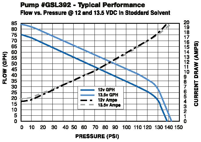

No problem - done that math set a couple times. We run three in parallel (constant-on - just make sure you've got a big enough return on your fuel pressure regulator!) on the high-horse (1100+) twin turbo engines.
Here's the plot for the 392 for reference.

Thanks for the map! Do you have a resource for other manufacturer's pump plots?

I've seen a couple plots for the larger Aeromotive pieces - honestly, though, the best thing I can recommend would be to run multiple 392's. They're damn near bulletproof... We've had a lot of trouble over the years with the fancy 'drag race' billet pumps that a couple outfits are building... Not a hiccup ever out of the little Walbros.
Bosch bulds a real similar pump in a couple different sizes, but it's a 'Motorsport' part and very large $$.
Every manufacturer should be able to get you a plot like that. If they can't, don't buy their pump, they haven't done their development work, plain and simple.
