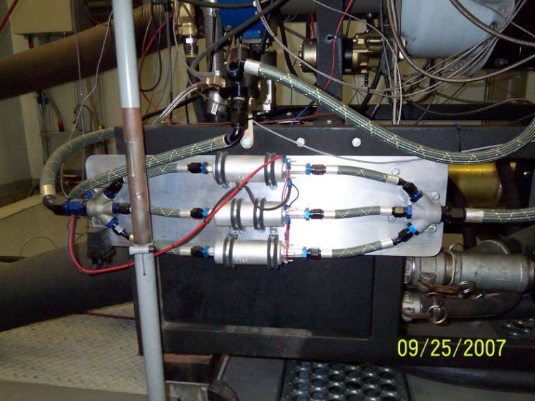

Here's a couple Parallel pump setups.
The first setup with the massive feed lines are Bosch Motorsport FP200's - rated for over 200 LPH at 8 bar (115+ PSI). Big boys - the inlet is an M18. That setup fed over 1300 RWHP.
The 392's are our dedicated engine dyno cart setup.
The only concerns I would have with running a setup like this on the street would be heat affecting pump longevity. As long as you're running a full bypass system the fuel will keep the pump body fairly cool - it never hurts to mount them in a spot where they'll still get adequate cooling airflow.
Don't cheap out on your wiring though, and definitely use relays.
Attached Thumbnails Max power from a Walbro255?-bosch-fp200-x3-leno.jpg   Max power from a Walbro255?-dyno-392-x3-setup.jpg

They'll pull up a pretty good column - haven't tried to fit them into a late model truck stock tank / pickup arrangement yet though. You'd need a serious lift pump setup to keep three of these fed.
Sorry I don't have a fix to offer here - may be getting around to it before too long, however.
