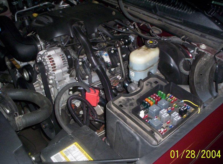

Here's a three pics of the LT1 fans I installed in my truck for those who may be interested. One is the power hook up to the fuse box (yellow wire) and to the red box on the drivers side (red wire barely visible at bottom). One is of the relay/thermostat controller and the other is of the fans themselves.

Nice install. I see you utilized the stock fan shroud bolt holes as I did to hold the fans.
