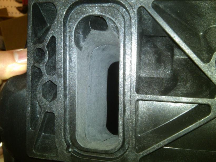

Can you make the LSXrT intake fit LS3 heads by switching out the bottom shell?

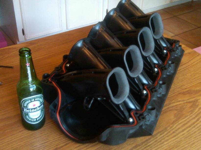

Yes but the runners are not going to be the same shape as the rectangle since they are cathedral ports. All lsxr manifold parts are interchangeable.

No, the runners are sealed to the bottom shell individually. The runners would not fit on a rectangle-port setup lower shell.
