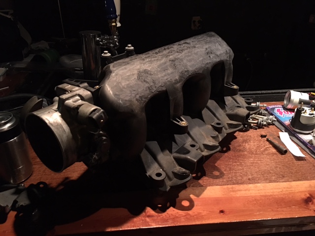

Just saw this thread as I did mine yesterday and was wondering if it was ever tested with boost. I used one of those oscillating cutters from Harbor Frieght to take the garb off. It worked GREAT!
I used a Mac Tools type 5 airless plastic welder to do the job. That thing melts the plastic in deep.
Mine's going on a jet boat running an LS1 with twin GT-35's at 18 PSI.
