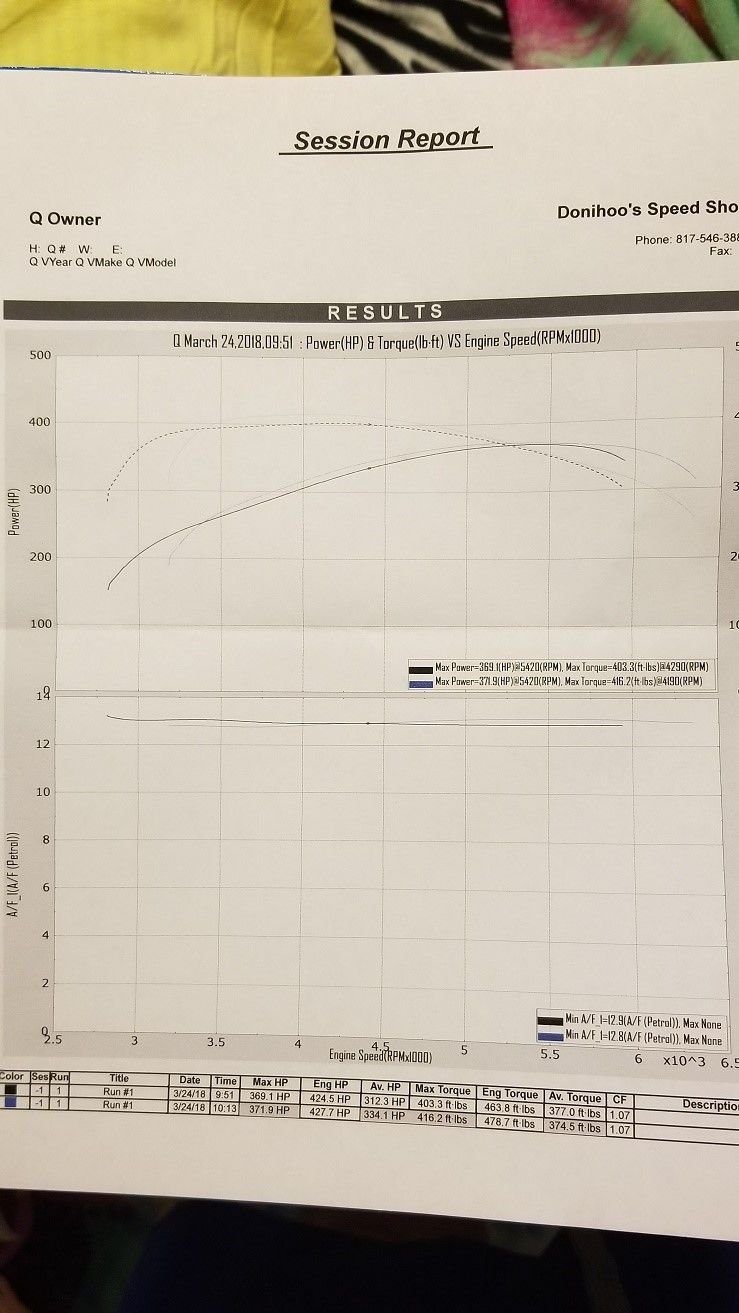

i put down 371/416 on my old setup on a dynocom with my lq4, 218/224 howards cam, nnbs intake mani ported, headers, 4.10 gears, 799 CNC heads milled .030
my current setup is in my sig upgraded to a btr stage 4 truck cam added 4.30 gears installed a ported lsxrt manifold tuned by james karger, just a street tune no dyno numbers and it has towed my dads big tex 12' dump trailer with 40 squares of shingles for what its worth.. it can be done. and im on the stock stall stock trans.
this was with the old setup 218/224 howards cam

I stand corrected. Did you run a stall?

no brother im still on the stock stall stock trans its crazy because i have beat up on other vehicles and a lot of dyno pulls and the trans is running good still after 2 years of being behind the LQ4. i do plan to run at least a circle D 3000 stall and have the trans rebuilt, with the addition of the 4.30 gears and the truetrac i get zero traction from a digs, i spin a lot from 20s and 30 rolls. when i do 40 rolls it will chirp the tires a little. im running some cragar soft 8 wheels 17x9 with a good year 275/60r17 tire. they are worthless lol
my dad has a 07 classic 2500HD and used my truck to tow the trailer while his 4L80E was being rebuilt and told me that my truck pulled the trailer way better than his lol maybe because its a lighter truck and the gears but he said it didnt struggle at all.
