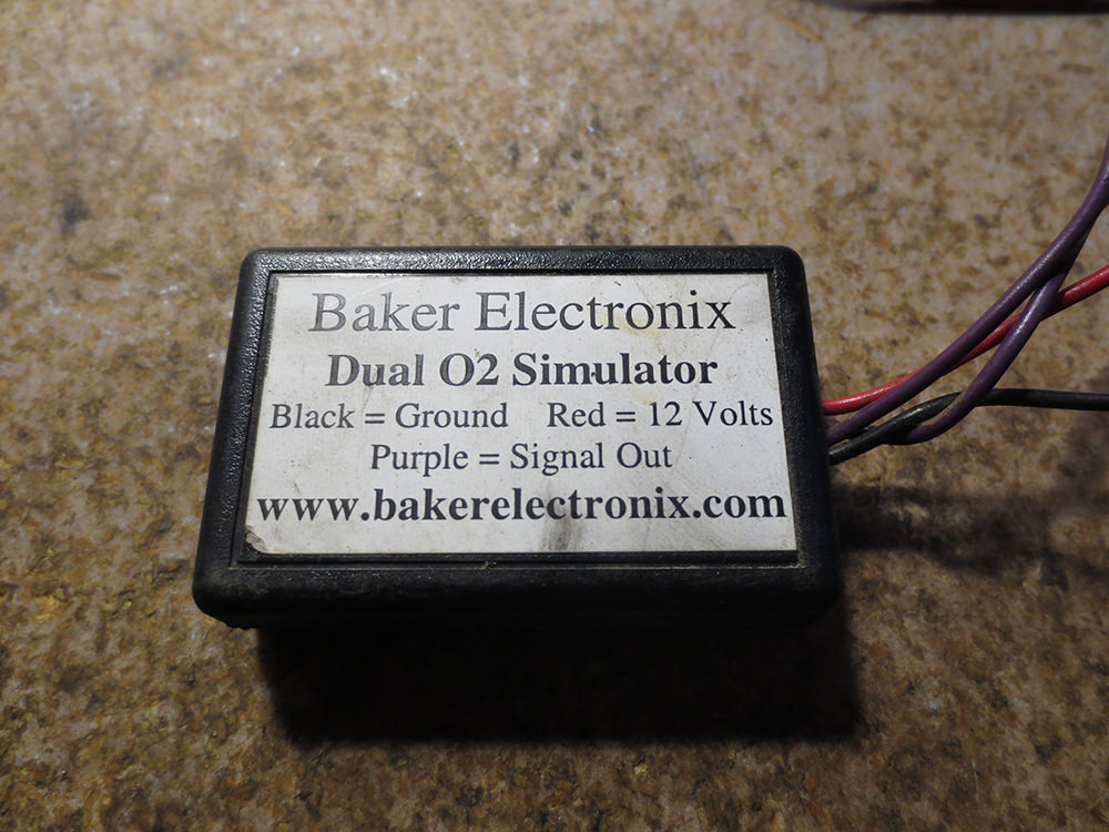

See if you can find some o2 simulators it will save a lot of time and money. I bought the baker electronics sim 14 years ago for around $25 when I deleted my cats. Worked great all these years until I recently built another engine and bought HPTuners for the truck.
