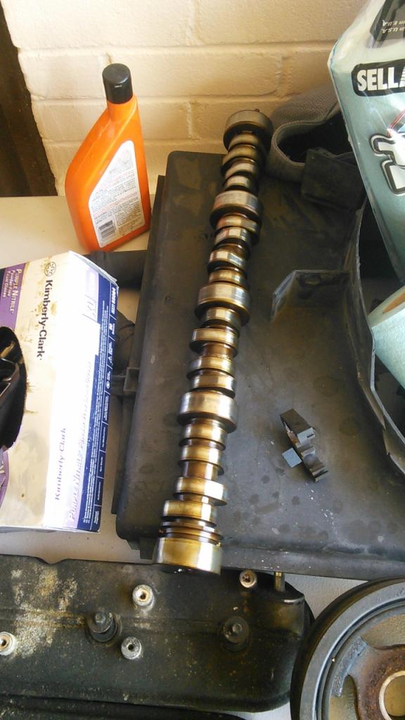

Got the cam out yesterday.

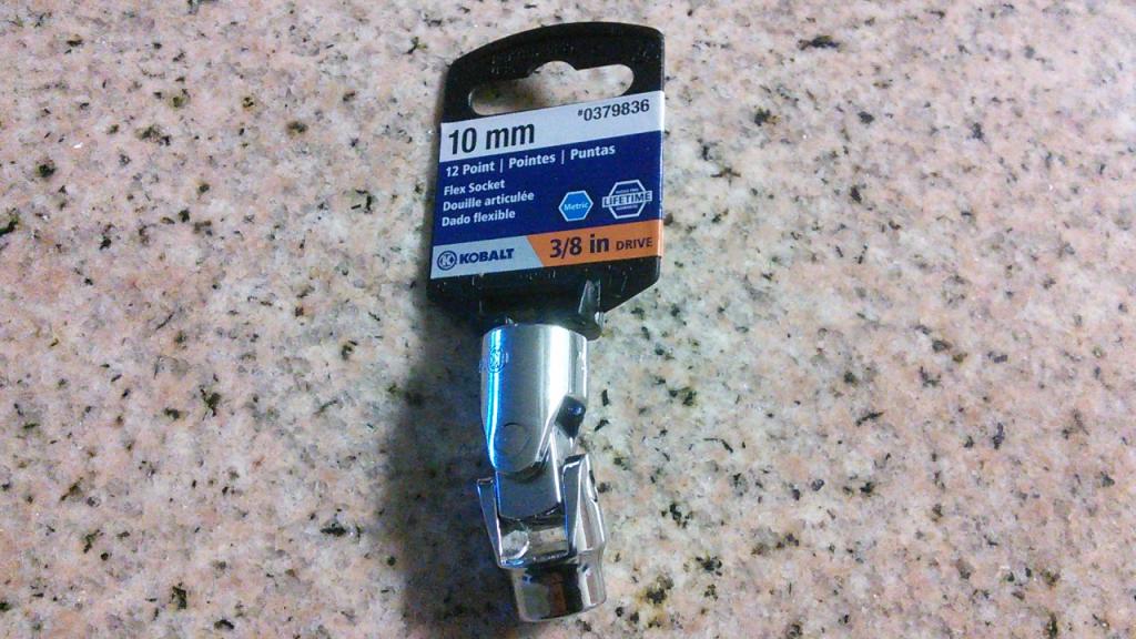

I did however find the tool I needed to get my oil pan off!!!!
