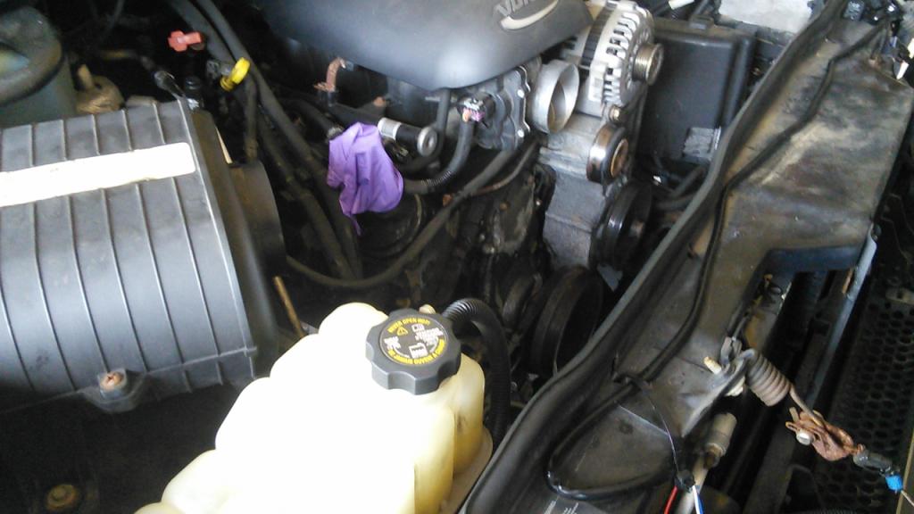

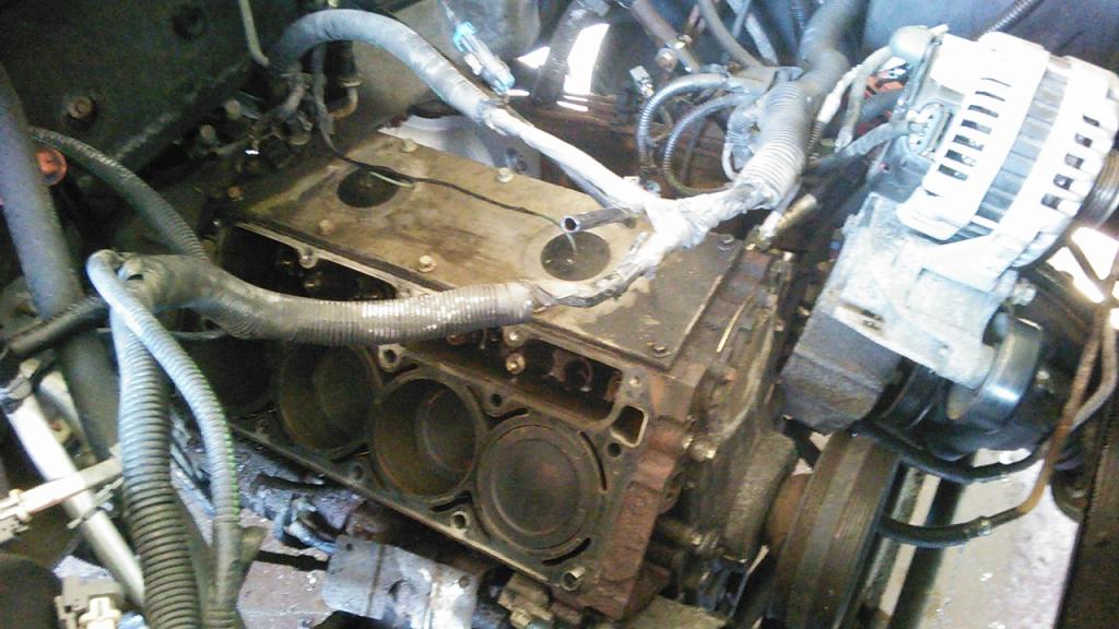

Been working on it the past 2 days. Got the heads and intake off today. All the exhaust is off also. Planning to pull the pulley tomorrow, however, I am not looking forward to it.
Yesterday got the front broke down and radiator out.

Today, intake heads and exhaust gone.
