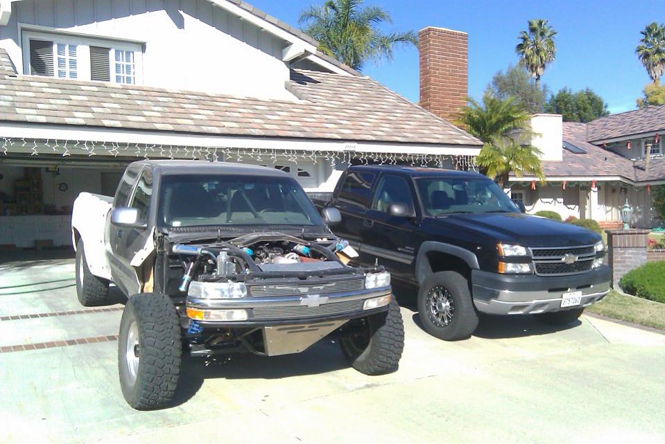

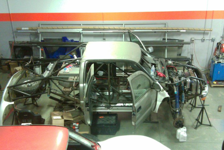

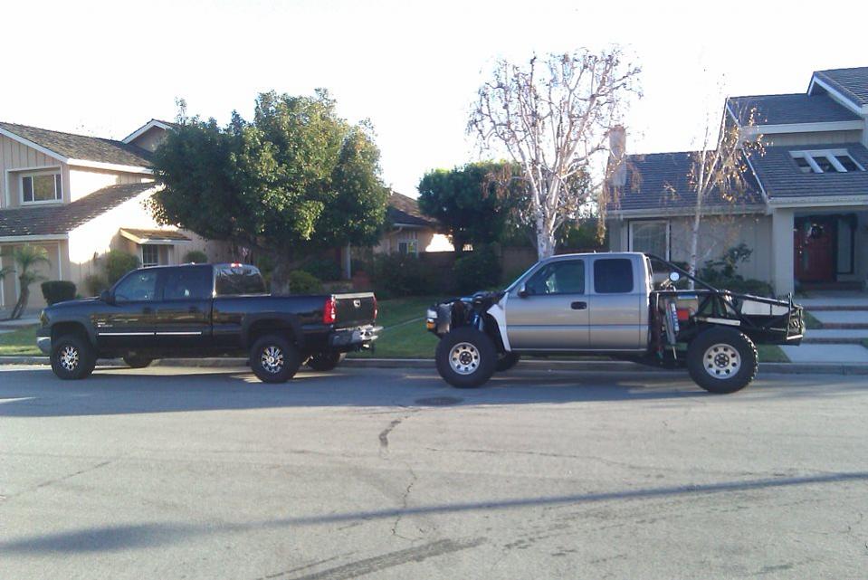

I don't know a whole lot about the engine (no build sheet). I do know that it is a 402 with 241 heads and yellow valve springs. truck intake manifold with stock throttle body. the cam sounds weak also (no cam spec card). the truck dyno'ed 285 at the wheels with a manual vb 4l80, 2500 stall torque converter, 9" 5.43 ring&pinion and 37" tires. probably about a 30% drive train loss. I'm disappointed in the numbers. what can i do to squeeze out an extra 100rwhp naturally aspirated.

i wish that was an option but given the nature of the truck, smaller tires would give me more problems.
