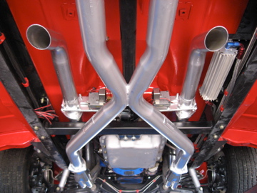

Hey guys I wanna put LTs on my truck and while Im there I wanna do some modifying of my current exhaust...I have a true dual set up and I see now that I should balance the two pipes with either and X or H pipe...well I found this on Jegs for cheap and I think Im gonna use this if you guys think it will help???...if I do get it I was just going to cut the middle section to length and reweld...def. seems the most easiest way to go in my case...what do you think???

Go with an x-pipe rather than an h. It'll flow better and just be better overall (like sound, packaging, etc) IMHO. I just picked up a new Magnaflow one for like 1/2 off on eBay.
And yeah, the ideal place for the cross over is as close to the collectors as possible. You gotta be reasonable here, especially in our trucks where the exhaust has to be run down the passenger side.
On my old truck ('66 Chevy) we put the e-cutouts before the x. The x helps flow by balancing out the pulses, lowers the dB level, and other things, but when you got the exhaust totally open, its already gonna flow like no other and who cares how loud it is. Thats why you got them in the first place!

I would make a custom collector pipe coming from the headers to the true duals. If you are not going to run cats, I am not sure how much better the engine is going to flow with cut outs. If ypu just want the sound of open headers, then go witt the e-cutouts.
