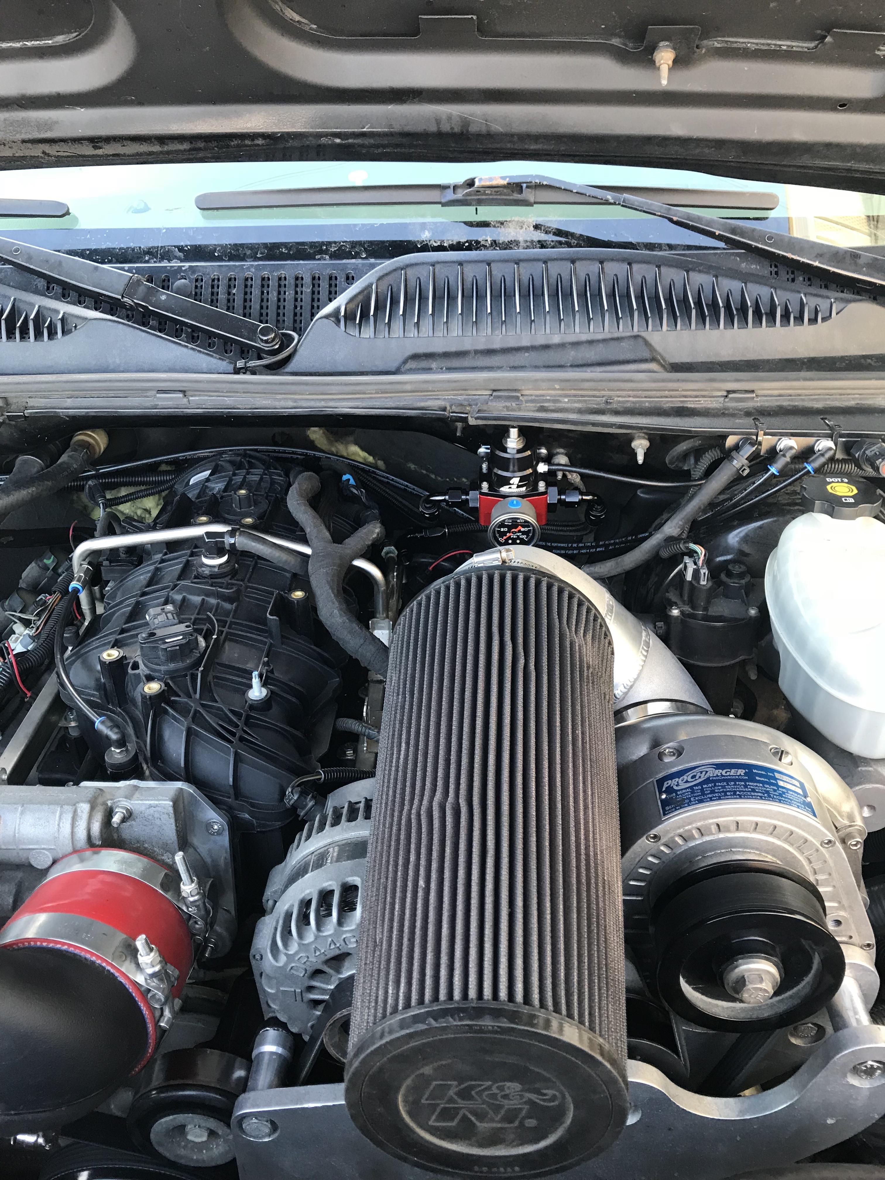

Mounted to the firewall.
Factory feed with -6 return. Walbro 450 in tank. Holds 58psi perfect. Also wired a holley pressure sensor in and logged it through HP tuner. Rises correctly with boost.
Typical fuel bucket mods. Return dumps into bucket and the plastic venturi on the bottom of the bucket drilled out to 1/8"
Edit: I welded a -6AN fitting to the stock fuel rail as well.
