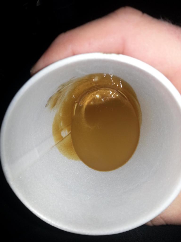

I get that same mix in my catch can, stock lc9 5.3. I usually only get that kind of mix in the winter, I think it's condensation. In the summer it's only oil. But, I don't get nearly that much. I get 2-3 Tbsp in 1000-1500 miles or 2 months for me.
My last dump:

It's condensation. I originally had my catch can mounted right next to the headlight to keep it cool hoping it would catch more stuff, but it would fill with the creme colored yogurt-like stuff that would clog the catch can's drain. It would do this really quickly too. So I moved it next to the alternator and now it only catches oil.

humid climate, short trips, not getting oil hot.
probably have it under neath the valve covers too
