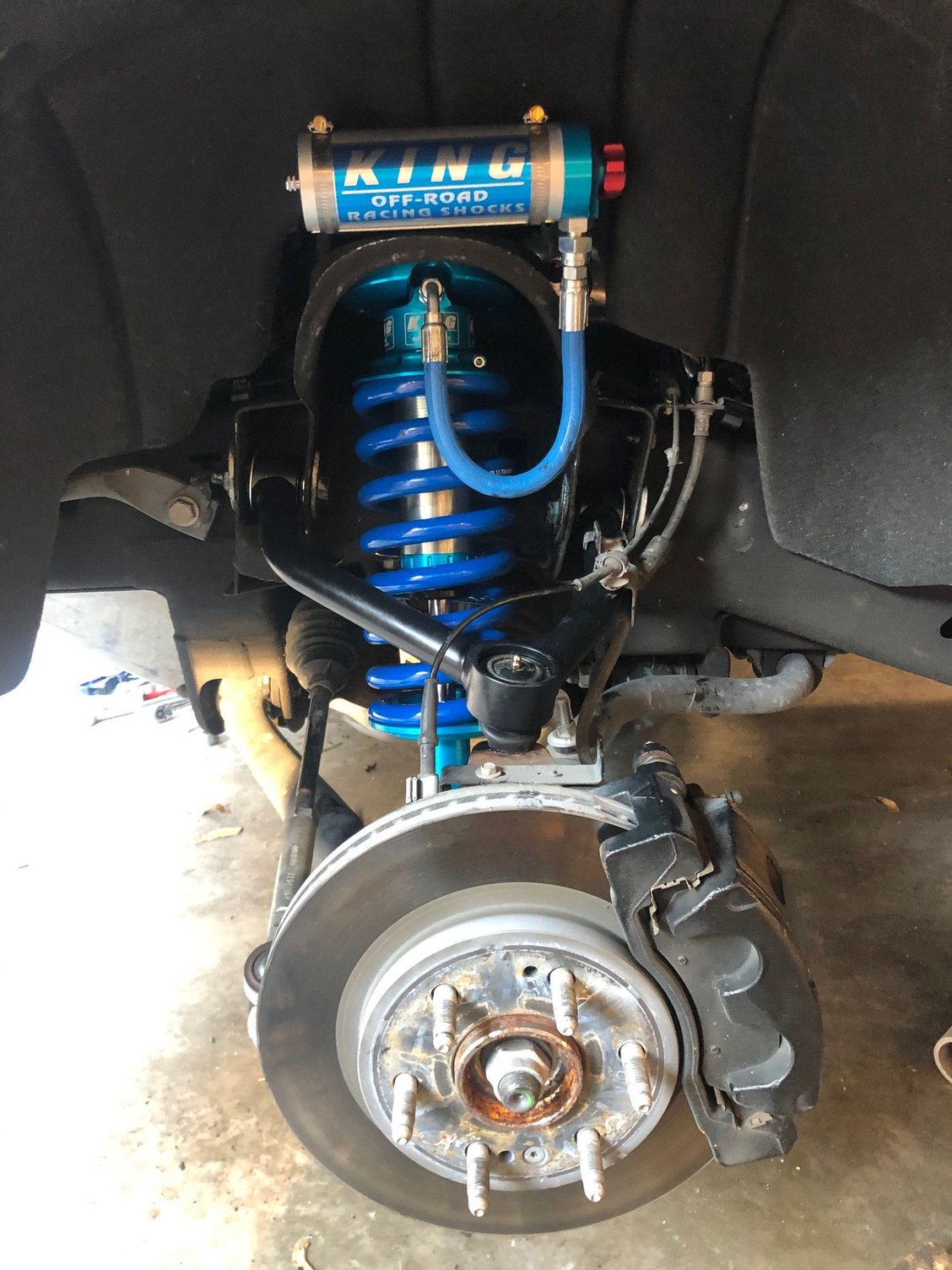

What suspension mods do you have so far?

do you daily your truck or off road with it? What didnt you like about the factory suspension? Thats a hell of an upgrade.

I realize i'm crossing interests here a bit, but I've always wanted my truck to good at many things, but not necessarily perfect at one. I MTB, hike, and other off-road activities, but I've also owned a CTS-V2 Wagon, CTS-V3, ATS-V, and C7-Z06 in the last 5 years and tracked (road course) them all.
