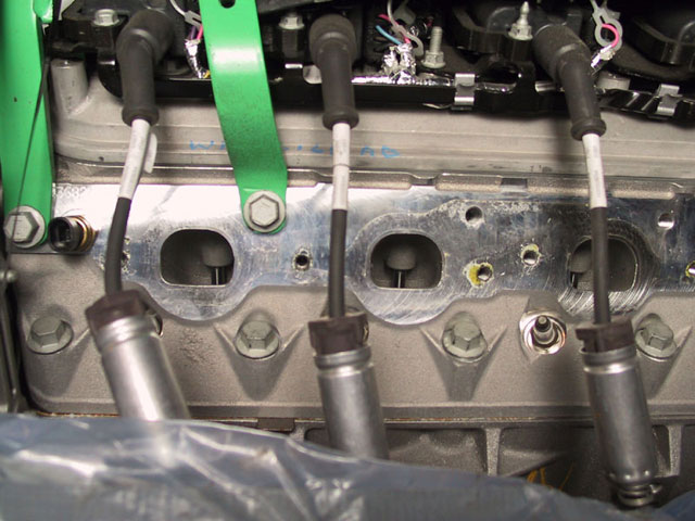

I recently found out that the L33 head has D-shaped exhaust ports.
Since every header I have seen is built with round ports, I am curious how this will affect the truck.
Does anyone know if this will make much difference?

Don't worry about it...the LS6/LQ9 heads are that way and MOST SBC heads are like that, until someone invents a D-shaped pipe to mate to it I wouldn't even think about it anymore.....
