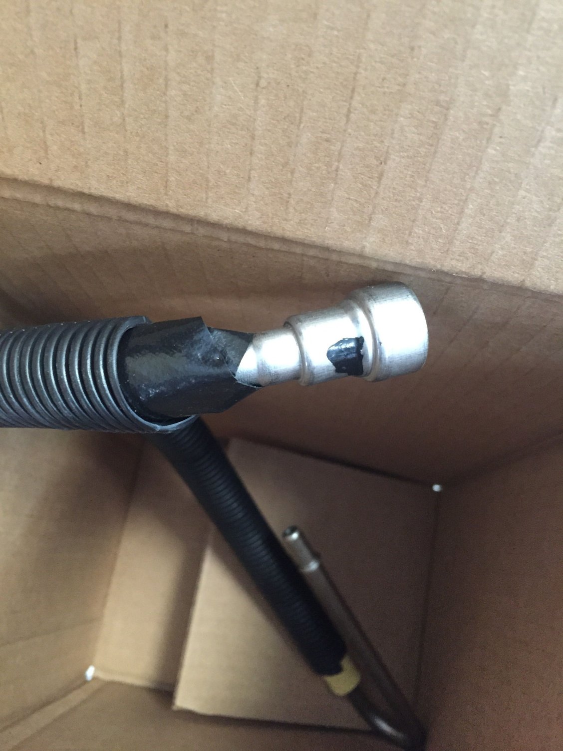

Its not its a metal/rubber line....
Old Mar 21, 2016 | 11:50 AM
Wolftrk99's Avatar
Joined: Jun 2013
Posts: 5,492
Likes: 48
From: Virginia Beach,VA
25948212
Has plastic convulted tubing over it but its not a plastic line...
Old Mar 21, 2016 | 12:25 PM
Justhereforinfo's Avatar
Joined: Jan 2013
Posts: 347
That's the one. Is the hose that's covered by the wire loom flexible? I'm just curious if I can shape it into something use-able, where I can mount the filter/reg, maybe on the firewall...
Old Mar 21, 2016 | 12:31 PM
Wolftrk99's Avatar
Joined: Jun 2013
Posts: 5,492
Likes: 48
Heres what i had originally done with mine, my plan with the new line is to loop the bend in the metal part of the line around the crossover out of the filter and loop ig back around to the fuel rail, way i am set up now my fuel lines arent rubbing the firewall they are basically in same spot they were on the original intake just pulled over towards the brake booster slightly....
