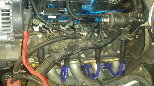

Yup, I've seen that pic quiet a few times. But that's not that same corvette hose, right? I'm trying to use only factory quick DC lines. I'd rather not use any hose barbs or clamps if I can.

Is the fitting on the fuel rail 3/8 or 5/16 quick DC?

Nothats a hose i made at the time.....

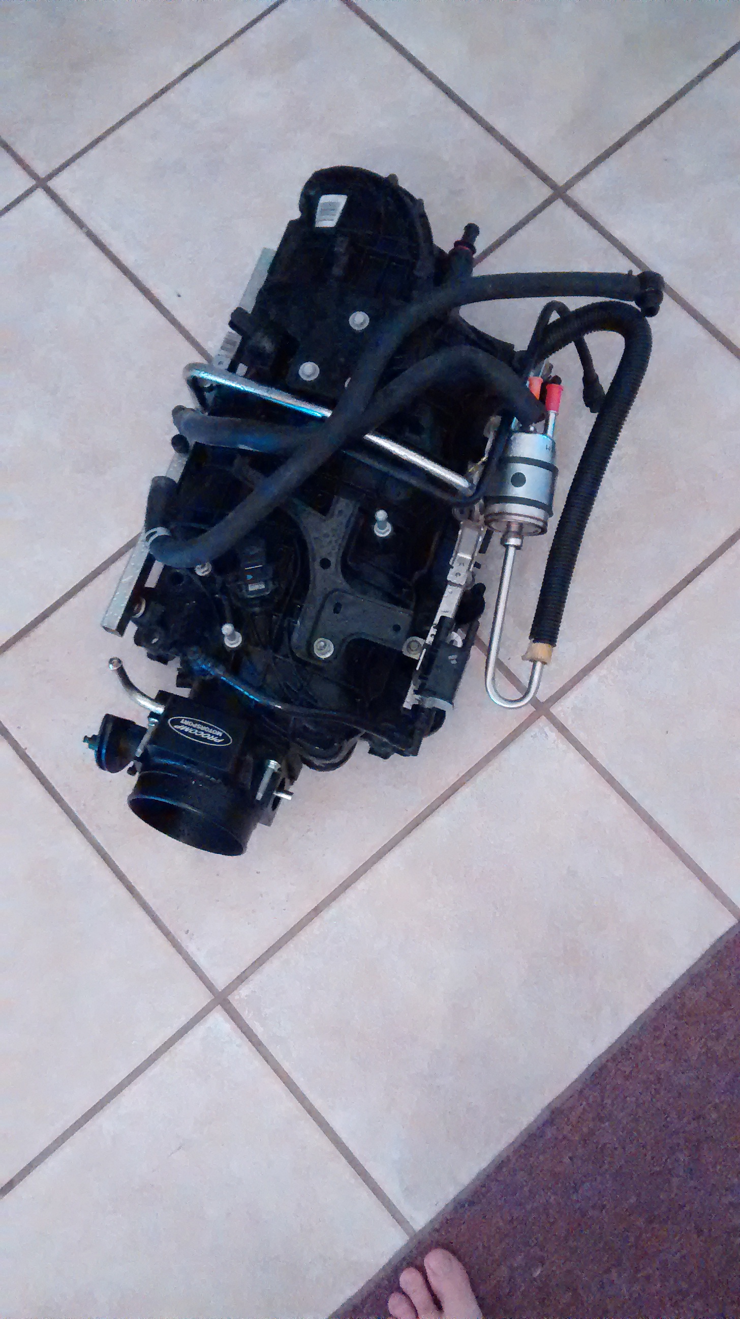

I still need to mock up my intake on the long block and work out mounting the filter. But you get the jist...

Thanks for the visual. Depending where you buy that hose from, it might be cheaper, and better looking, to buy two nice -6AN fittings and two feet of hose. Where did you buy yours from? I can only find them for $50-60.
So is the quick connect fitting on the rail 5/16? Just like the larger feed line from the tank?

I wanna say there is one of each on the one end of the vette filter and the fuel rail is 3/8" but i may be wrong havent seen one in a couple weeks.... Lol

You won't see it once I install the engine cover. (07.5-13 style) Not 100% sure on the size, but it is the same size as the larger outlet on the Vette filter. I got mine from a Corvette salvage yard for a little over $20 shipped. Looked brand new when I took it out of the box.
