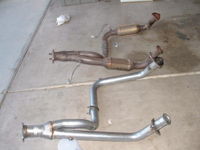

Pic (borrowed this from another member)
Side by Side..

Actually, the stock converters flow very well. Given a stockish engine, there's basically nothing to be gained power wise that you will feel from deleting cats. Your restriction is in the manifolds, upstream of the Y pipe. You could put the best Y pipe in the world on there and it wont matter with the bottleneck produced by the manifolds. I'm not knocking the product because it looks like an easy bolt in, clean way to delete cats if that's your thing. But I am extremely skeptical that doing this will give you any noticeable power gains, especially given the fact that the Y pipe is still 2 1/4" in diameter, regardless of the mandrel bends.

I have to fully agree with GMCtrk. Your money would be much better spent on a set of headers. A buddy was going to do a similar mod on an 05 Silverado 5.3L and we installed a back pressure gauge in place of a front O2 sensor for a test. Yes, it turned on the light, but we still got a reading. At WOT (wide open throttle) and 5,000 RPM while driving, he had .8 or 8/10ths of a pound of back pressure with stock cats and exhaust. Anything less than 5 to 8 LBS is considered to be fine and he had less than 1 LB. The only way you would have seen a real gain is if your cats were partially plugged from some kind of contamination. Your on the right track with the mandrel bent pipes, but I would have suggested moving in another direction. Good luck!
