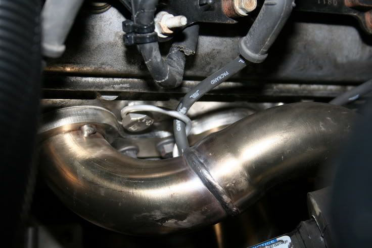

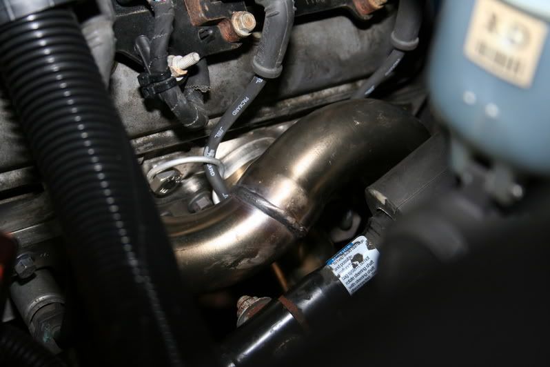

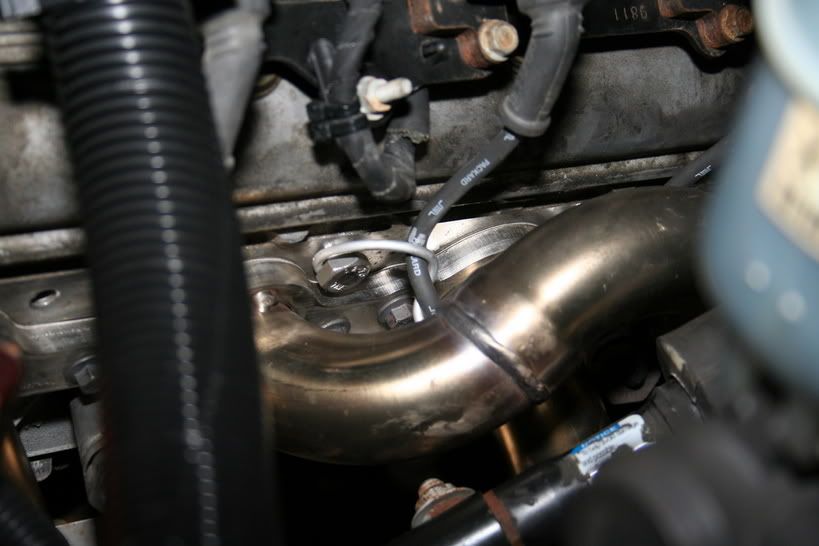

Here is how I prevented that from happening. I purchased some stainless bolts and heavy gauge aluminum wire. I screwed in the bolts just above the headers, wrapped the aluminum wire around the bolt and then around the plug wire and adjusted it so it did not come in contact with the header.
See pics.
