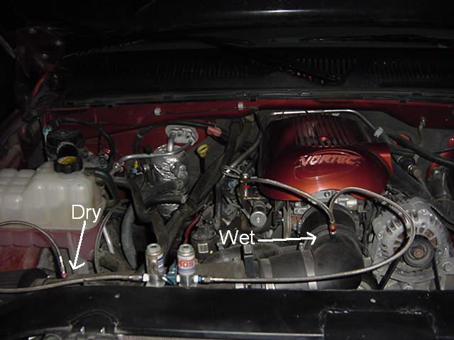

I made my own for just pennies. If you have e-fans there is ALOT more room.
This is a pic I had around that shows the intake..
