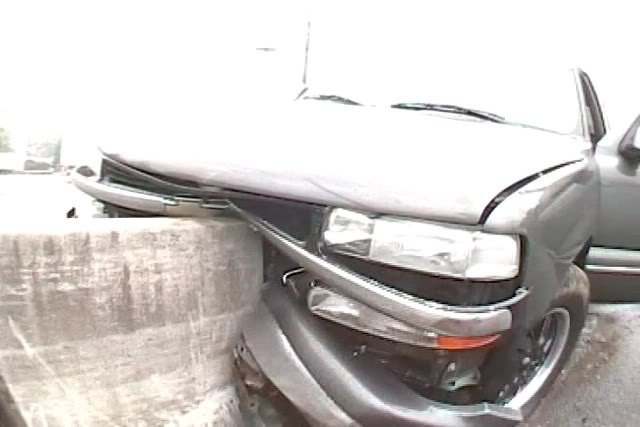

wow, i feel like a re-tard. I decided to check out my wiring harness and i found a wire that was cut in half, literally hanging on by a thread. so i fixed it and now the HOE is feeling good again. Oh. this is why the wire was cut. i screw up recentley
OUCH!
