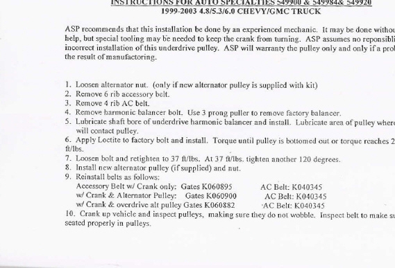

If you are JUST using the ASP Crank Pulley and not the alt pulley are the belt #'s you need K060900 and K040345.

Here are the instructions that came with my pulley, it list the belts you will need in each application and usage. I just got it in the mail today!
