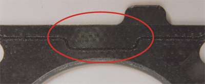

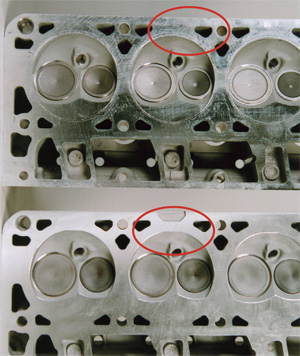

When mating a 99 block with a 03 heads What head gasket will i need to use? the 99 or the 03? They both have the same thickness compressed.
You need to check the head first!!! In 99, some of the 862 heads had a notch in the deck surface.
If you do NOT have the notch then you can use either type.
If your heads have the notch in the deck surface, you can only use the Fiber type gasket.
There is a good explanation here... Gen III GM Small Block: Engine Builder
I copied and attached the pictures from that document.
Good news the new heads do not have the notch and the gasket is head specific not block correct as long as its for the 5.3
That is correct. Either style of gaskets for the 4.8/5.3L will work since you have no notch. The 4.8L/5.3L share the same block and bore size. They also use the same head with the exception of the L33 option.
